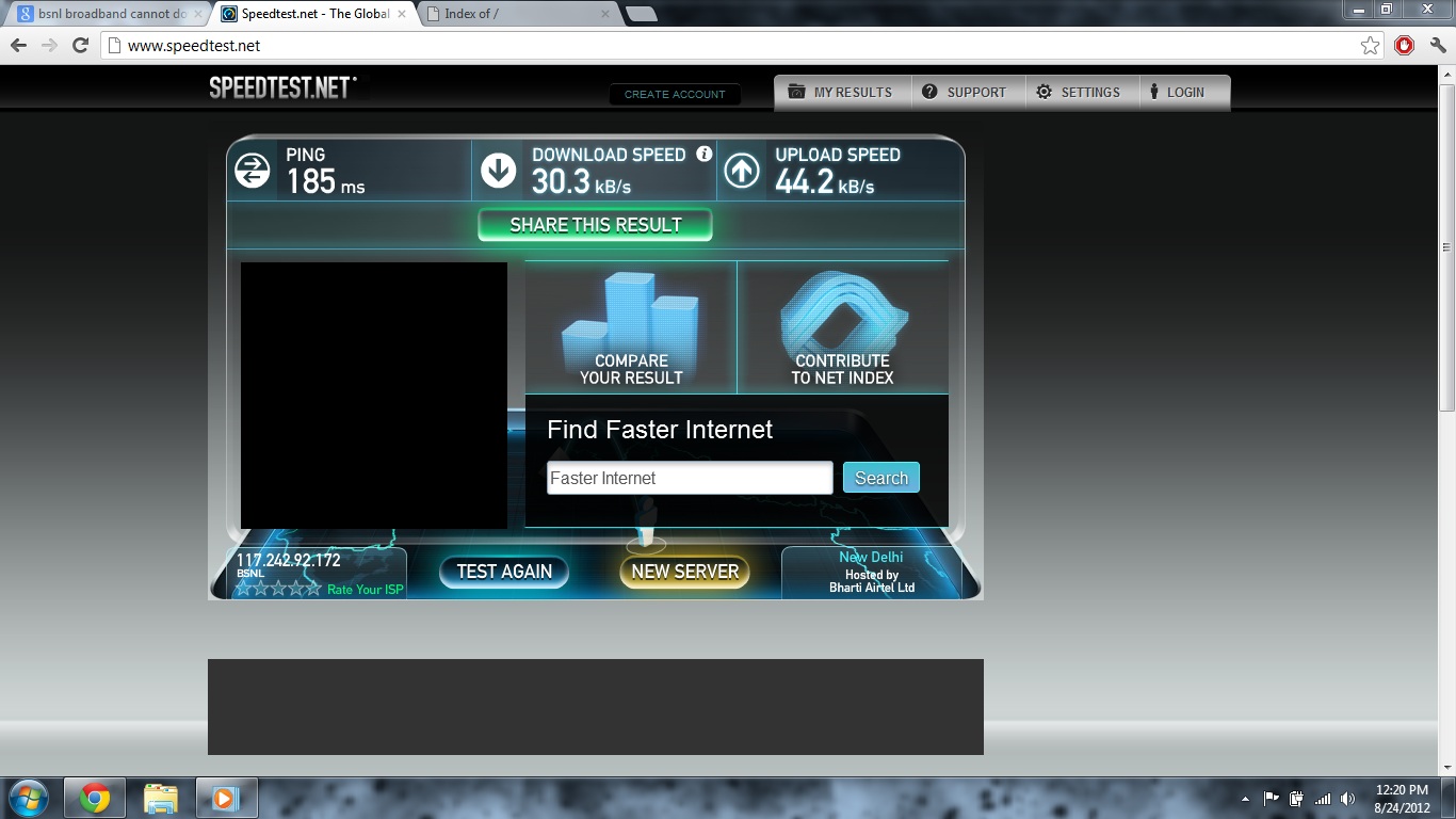

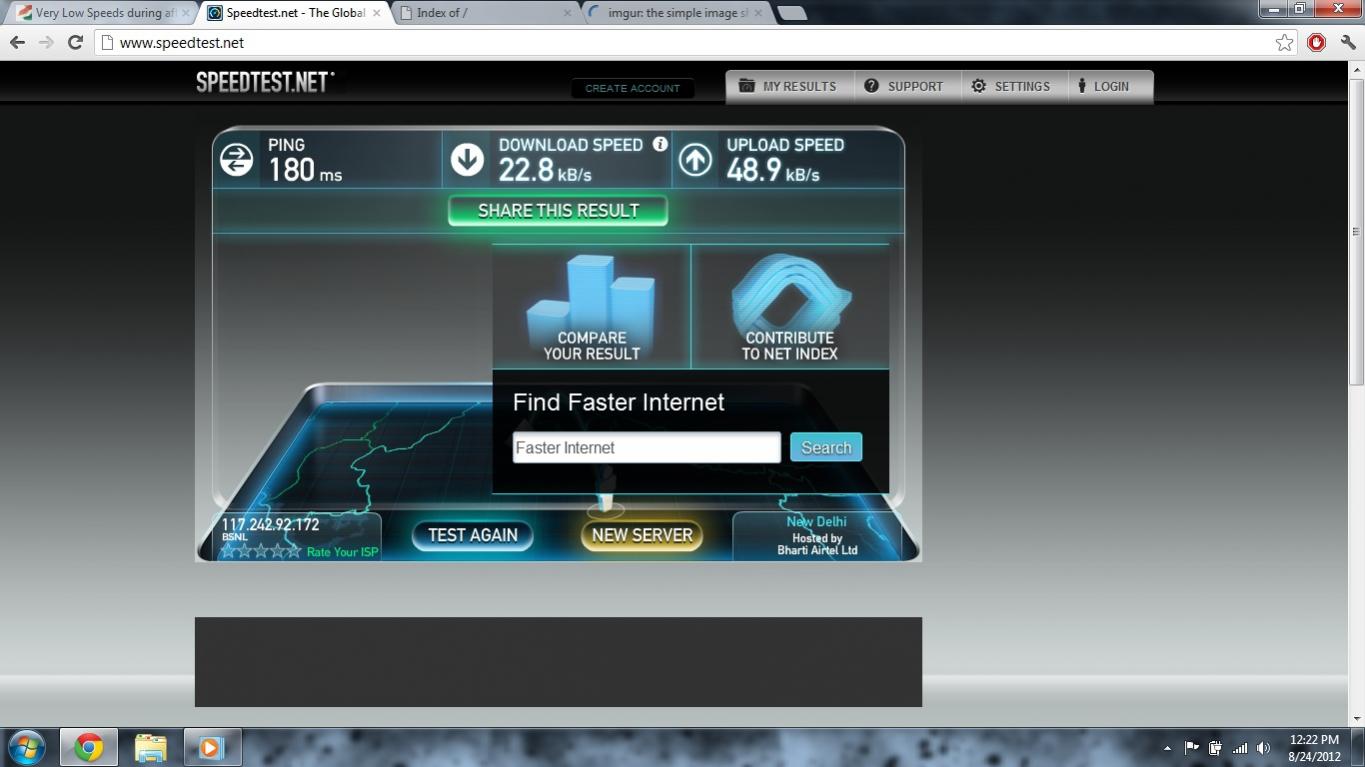

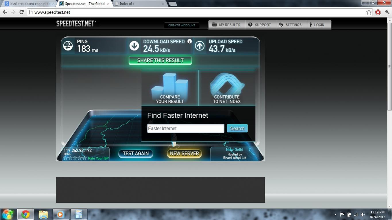

Hey guys from the last 2-3 days getting very slow speed on my UL 750 plan. Test 1.jpgTest 2.jpgTest 3.jpg
Ran speeedtest three times,as you can see I'm getting almost half of what I should be getting.
Ascendant001
never rely on speedtests for actual download speeds.try downloading some big file like directx9c redistributable(~100mb) from microsoft site or some big software setup from sites like file hippo using a download manager like FDM/orbit/flashget etc to test speed.if still low speed then check SNR & Attn values in modem info which indicates line quality.
