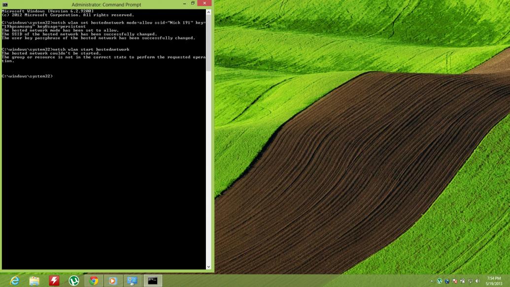

Nope right now m using Samsung's Given software to make it but i have tried using Connectify-me but doesn't works... It get connected from Mobile than it display connected in Laptop but after some time it doesn't show my Device connected but shows connected in my mobile... This is not a problem of mobile coz i have tried using another phone also...
I am also saying the same that its an issue with your Windows. You mentioned in your first post that you've tried through CMD also, so can you post the commands that you typed in because may be something went wrong in setting it up manually via cmd.

i have used this guide How to Turn Your Windows 8 Laptop into a Wireless Access Point

Start over again & set up using those commands (do post the screenshots too):
in the line: netsh wlan set hostednetwork mode=allow ssid=”How-To Geek” key=”Pa$$w0rd”
Append this: keyUsage=persistent i.e.,
netsh wlan set hostednetwork mode=allow ssid=”How-To Geek” key=”Pa$$w0rd” keyUsage=persistent
You have to broadcast your network everytime you resume your PC from Sleep/Hibernate/Shutdown:
netsh wlan start hostednetwork

Getting error...
