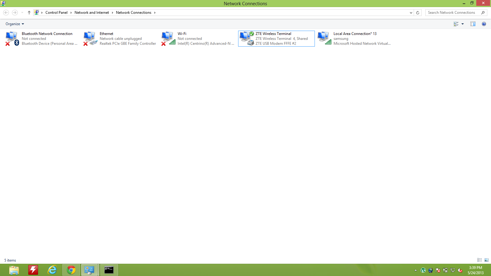

nick191
u didn't posted the Change Adapter Settings window ... Network & Sharing Center-->>Change Adapter Settings... post a screenshot of this to look at the adapters that you have
here it is...

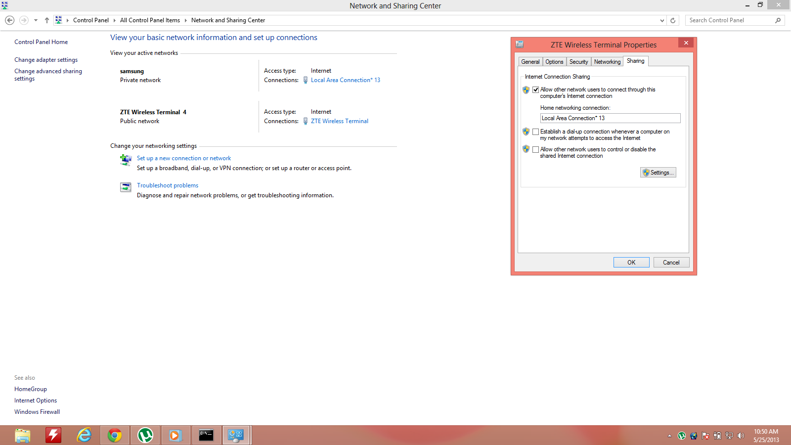

Great! When you go to the Drop Down List under Network & Sharing Center-->>Change Adapter Settings-->>ZTE Wireless Terminal-->>Properties-->>Sharing-->>Checking "Allow other computers to connect through this connection" , what connections do you see? One must be "Local Area Connection *13". Do you see any other?

nick191
done...no change

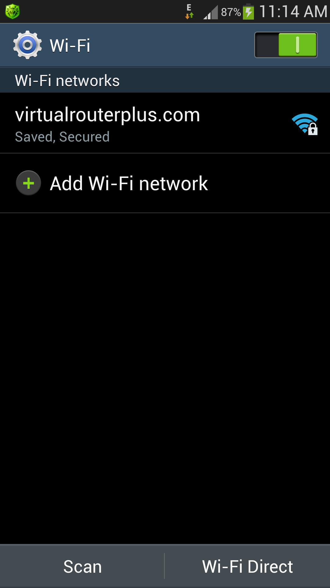

Go to your android device and under wifi settings when it finds the AP or hotspot .. touch and add password and enetr all others value manually .. in Ip adress field select static and give this ip :
192.168.137.2
and all other like gateway, DNS1 and DNS2 should be 192.168.137.1 and the subnet prefix is 24 and now try to connect.
saved,secure but not getting connected !

topgear
done...no change
don't know why but the hotspot on pc and android should have the same name .. your pc's hotspot name is samsung and android device is trying to connect with virtualrouterplus which itself is a software ... so first make sure the virtualrouterplus app is not running in the background .. uninstall/remove it - reboot the pc and try again.
theterminator
Exactly, ..how did I miss that! The mobile should have the same name as is on the pc.. virtualrouterplus is an old connection which your mobile has saved. Thats why its showing saved, secure. You should turn laptop n mobile's wifi on, start network from pc n connect to it from mobile.
