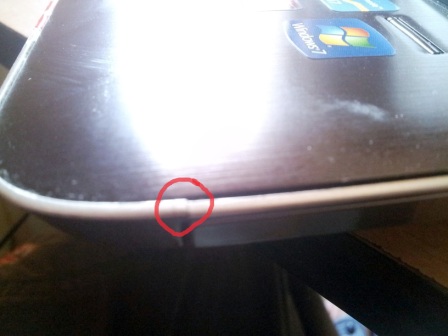

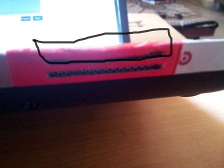

Hi All,
Need your help i am having HP DV6-6165tx and i am having problem with my base enclosure it is having crack. 2 months back i seen a crack near by the subwoofer. And i tried to fix that but the plastic was so cheap that it got worse so i used (M Seal) industrial grade epoxy compound to make the exact design to cover that broken plastic and hide that with colourful tape. But now again i am having one more crack near by the DVD drive. I am the only person who is using the laptop and let me assure that the laptop never fell or hit to something that will cause this breakage.Now i am not sure whether i should call HP for the replacement or not cause they might cover this in physical breakage but as i already told this is not physical breakage.So want to ask what should i do and feeling that why i bought this laptop i would have gone for dell. :(

@SHivesh
Bro,you've greatly messed up your laptop near the speakers.
However I do admit that there is a design flaw near the dvd writer drive that the crack has appeared.On my laptop alone,I have changed the base enclosure 3 times.However I changed when the crack was fine,and hence hp could not detect it.The plastic there is so fine and soft that it is bound to get cracked even if you mishandle it a little.That is a design flaw,though hp wont admit it.:cry:

Hi All,
View attachment 10062View attachment 10063
similar crack here as well

@Shivesk.kumar03
@samudragupta
I had similar cracks near the front speakers. HP replaced my Laptop's base enclosure under Accidental Damage protection.

@Shivesk.kumar03
@samudragupta
unfortunately my laptops cracked occurred after the 1 yrs warranty. now the extended warranty does not cover accidental damage.
Prongs298
mine is still fine. these areas of the dv4 and dv6 are not very well built, esp. around the dvd drive area. my friends dv4 silver thing is faded. it looks bad. mine is still fine.
