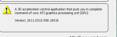

What is the latest stable ccc release? is 12.10 stable ? How can i install it , should i over run it or perform a clean install by removing the present version ( it is the default ccc). Actually i was having some glitching problem while playing COD:MW3 in medium settings ( But HITMAN Abso;ution worked well and in fraps it was showing more than 30 fps at medium settings) , I think DV6-6165tx is capable to run CRYSIS 3 beta or Max payne 3 at playable fps,but i don't know what things are required to be updated to run Battlefield 3 or Max Payne 3 , Has anyone played these games if yes @what fps ? Please help me.This is the present screenshot of ccc Capture.JPG

What is the latest stable ccc release? is 12.10 stable ? How can i install it , should i over run it or perform a clean install by removing the present version ( it is the default ccc). Actually i was having some glitching problem while playing COD:MW3 in medium settings ( But HITMAN Abso;ution worked well and in fraps it was showing more than 30 fps at medium settings) , I think DV6-6165tx is capable to run CRYSIS 3 beta or Max payne 3 at playable fps,but i don't know what things are required to be updated to run Battlefield 3 or Max Payne 3 , Has anyone played these games if yes @what fps ? Please help me.This is the present screenshot of cccView attachment 8854
i did update my default CCC to 12.10 and then to 13.10 beta and i didn't noticed anything new or something like that , i had done updating over the previous version which comes default in AMD Raedon 6770M.
Gourav Kundu
How did you updated as in my case its saying hardware not compatible when i ran verification tool
harikt
What is the latest stable ccc release? is 12.10 stable ? View attachment 8854
The installation is a bit tricky but I've got 12.11 Leshcat UnifL Enduro drivers working properly.
You might be able to get 13.1 working as well. But I got a couple of Blue Screens during this install, so I played it safe.
If you're feeling adventurous, try the Leshcat UnifL 13.2 Beta 5 drivers instead.
