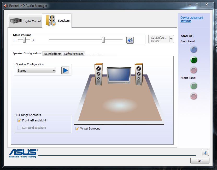

try speakers with another pc/laptop.also uncheck full range speakers(this option is for speaker system without woofer) though speakers should still work but just in case.in the speaker properties advanced tab uncheck option "allow applications to take exclusive control of this device" & restart.all of these suggestions are based on assumption that when an audio/video file is playing left clicking the volume icon in system tray show green bar moving up & down with playing audio.

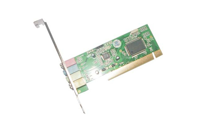

their professional pc- man attached a sound card in pci slot and made a bi-pass . and said that " Mobo's audio jack is wrecked now".
I did the same too ,but pc is not recognizing it ... the mini driver cd bundeled with sound card has no folder for win 7 (it has folders named winxp ,win vista, win 98 containing driver setup files.... And my 7 is 64bit). While I run the one from Xp's folder or vista's folder it doesn't work..
I mean the blue window appears with a sub-window and a button to press labeled 'next'. As i press the button the whole setup terminates....
So i am unable to install it's driver too.
now I cant understand what to do .....
please help
Name of sound card is named Quantum PCI 4CH Sound Card (chipset no. ess 1978)

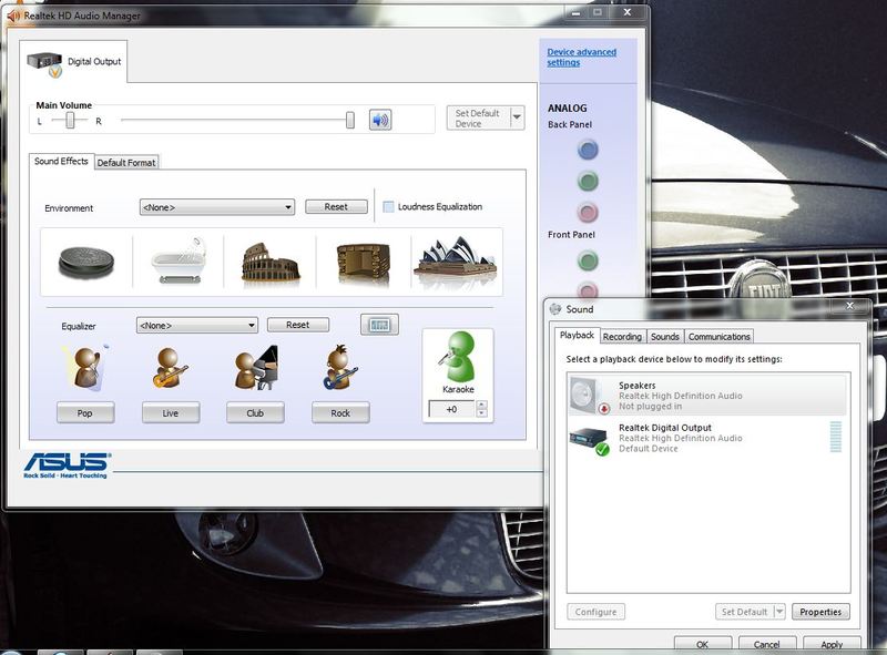

1. Right Click on Speaker icon on taskbar
2. Select Playback Devices
3. See your speakers
4. Click on Set as Default button
But before performing these steps make sure that you have selected them and make them as default device in Sound Control panel of the drivers as well. :)
I hope this helps. :)

^^op must get vista/win 7 64 bit drivers for his sound card for his speakers to work & i doubt it.i remembered buying a similar cheap 4 ch sound card which worked in xp but couldn't in win 7,that too 32 bit for which drivers are easier to find,because of no compatible driver.
