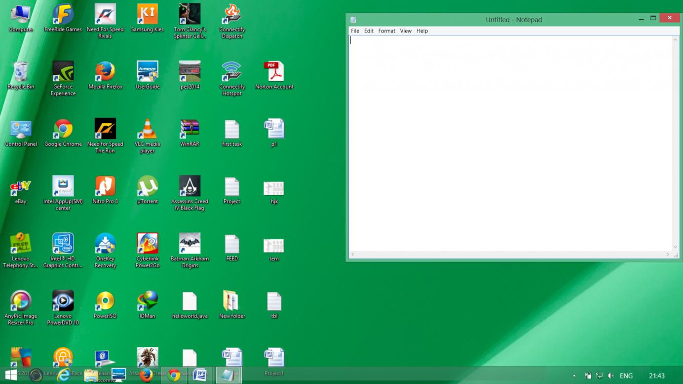

Welcome the another 8.1 bug.Can anyone helping me in solving this issue?
The dekstop looks completely messed up..folders and programs run fine in original resolution...but this happens to desktop and goes after restarting
WIndows 8.1

There seems to be some software problem in your PC. Try to Refresh or Reset your Windows 8 PC. To Refresh or Reset goto Charms Settings>>Update and Recovery>>Recovery

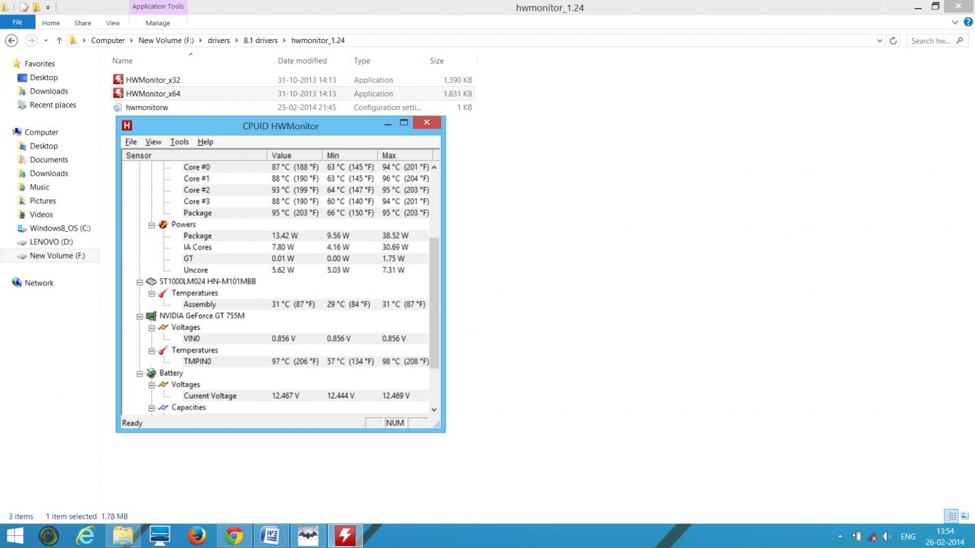

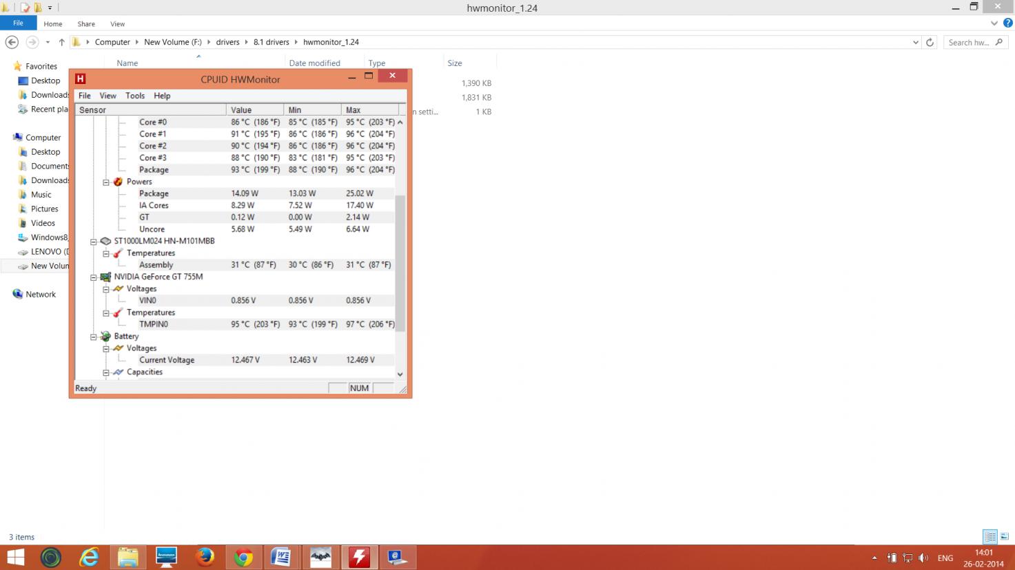

Here are the temps while playing arkham origins
What to do? Can anyone tell me what things to get replaced.Is it problem with heat sink, cpu fan, thermal pasting or mobo?
I think a good cooler is what you should be using on the first place. And as seamon said you need to play on a flat surface. While playing AC4 or bf3 it hardly reaches 90.
Try furmark or kombustor, it's gonna make you cry. Trust me. My cards barely reach 74 when maxing out metro last light for more than an hour.
Those temps are a bit on the higher side. You're prolly gonna damage the laptop if your GPU keeps those temps for a long time. Mine barely reaches 91 during kombustor(don't try this on your laptop). Never put the laptop on a soft surface, always use it on a table when gaming leaving ample space for air to reach the vents. if nothing works ask the service centre guys to repaste the GPU thermal paste.
Yep i am keeping this in mind but it seems to me something else..I think a good cooler is what you should be using on the first place. And as seamon said you need to play on a flat surface. While playing AC4 or bf3 it hardly reaches 90.
A Msata drive behaves as a normal HDD. I get 500 MBps read and 320 MBps write speeds. The first thing you should do is open the back cover and see if you have Msata or m.2 ngff. Onlyssd.com has all sorts of ssds. When I installed my ssd, I removed all contents of Hdd and reduced it's size to 40 GB, then cloned the Hdd to ssd and formatted the Hdd.
Thanks, actually all these issues happened after the laptop got replaced. Before that even while playing arkham origins, it never crossed 75 and was going perfectly smooth. Yes i have asked them to come with thermal paste as it is onsite warranty, hopefully that should solve it.
What else would you guys recommend from your experience. Yes i am using at elevated height and have used this for last 3 months without any single issue.
Thanks, now I have decided to get M.2 SSD rather than SATA SSD. I have researched on internet and came to know M.2 max throughput speed can reach 8GB/s if drive supports using PCI-E multiple lanes. Currently Samsung has released a M.2 drive which can reach 1.2GB/s. I believe in the near future M.2 will replace all the other SSD form factors, also Sony has released a new Ultrabook VAIO Pro 13 having only M.2 SSD
Name suggests it will burn my GPU/CPU
After seeing the attached temp pics, I think ambient temps are just fine because your HDD temps are low but your CPU and GPU temps are beyond normal. You should check whether the heat sink is properly fitted back after opening or not. Also reapply good quality thermal paste (as told by seamon) on CPU/GPU if problems aren't fixed.
