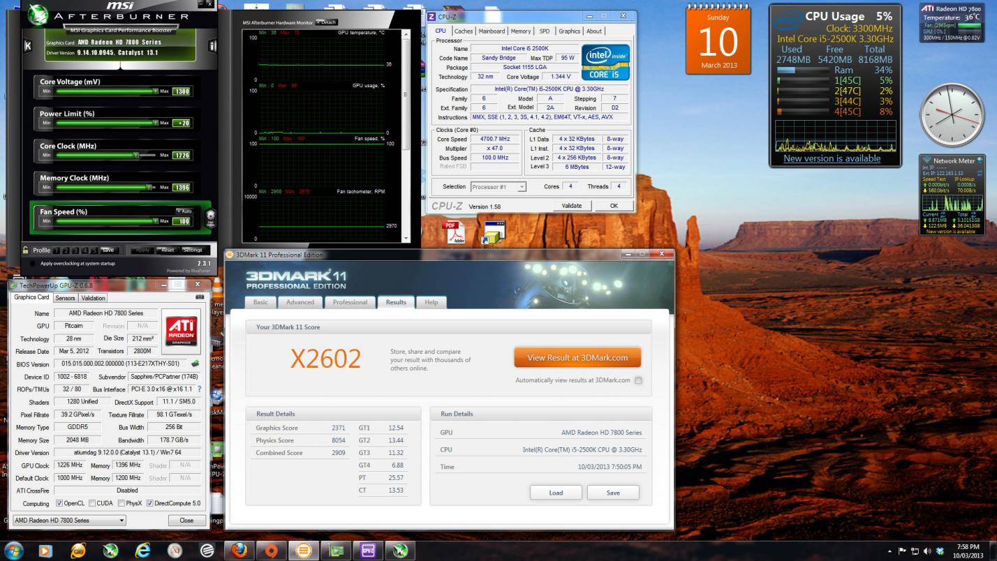

gagan_kumar
GPU : Sapphire HD7870 GHz Edition
GPU Stock Speed : 1000 Mhz
GPU Overclocked Speed : 1226 Mhz
GPU Core Volt : Cranked to 1.3 V
VRam Type : GDDR5
VRam Stock Speed : 1200 Mhz
Vram OCed Speed : 1396 Mhz
VRam Volt : Stock
Cooler : Stock
Bios Version : Stock
Software Used for OC : MSI Afterburner
Additional Notes if any :
that is even higher than 7950........
