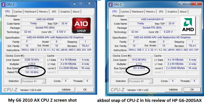

anujsetia
Re: HP G6 2005AX/2010AX/2201AX - powered by Trinity
I just saw the review of aksbol and goblin and noticed that the performance as well as the hardware config snaps is a little different from mine........
Apart from having a little performance degradation in Benchmarks and a little change of snaps on same config and settings
This is the main thing which is driving me crazy
Take a look at the CPU-Z snap of me and aksbol :chinscratch:
this--->View attachment 7744
As you can see the, the difference is obvious and rather difficult for me to even interpret but the Bus speed of both lappys quiet noticiable.....Mine being just a half of him....
Your friend's laptop has an older version of CPU-Z installed & it seems it didn't detect the processor & its features properly. See it doesn't even identify the processor name: a8-4500m
