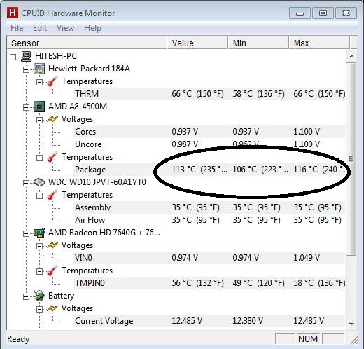

wtf??? the other temps are normal.
touch the laptop's bottom. is it hot to the touch? are there any hotspots, like areas where the temp is way more hot than its surrounding?
Try using Coretemp. Core Temp
what is this package temperature?
In my HP G6 2500, i am doing Visual Studio programming, without cool pad on my bed with a thin book, running for around 9 hours continuously, on high performance, temp does not exceed 55C. At max. Normally its 50C.
Ignore Hardware Monitor's reading. It is wrong.The bottom is perfectly fine.....and only hot when i stress out GPU and CPU.

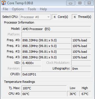

The core temp result ~ 50 C when idle and upto 68 C when on 100% load
and the freaking package temperature when on load

please with package temp...anyone owning 2010AX Help plz![]()

Can you plz verify it via HW moniter
My Snap---> View attachment 7710
Package temp at idle always at 90 s and at load you can see...

Yes, its 96-97C. I thought Speccy and CPU HW Monitor showed same temp. :O.
So nice to hear that the same thing is happening to you, this prove that this is normal
.....so happy and satisfied...there can be some calliberation issue with HW moniter....Rest all the temps are fine enough
