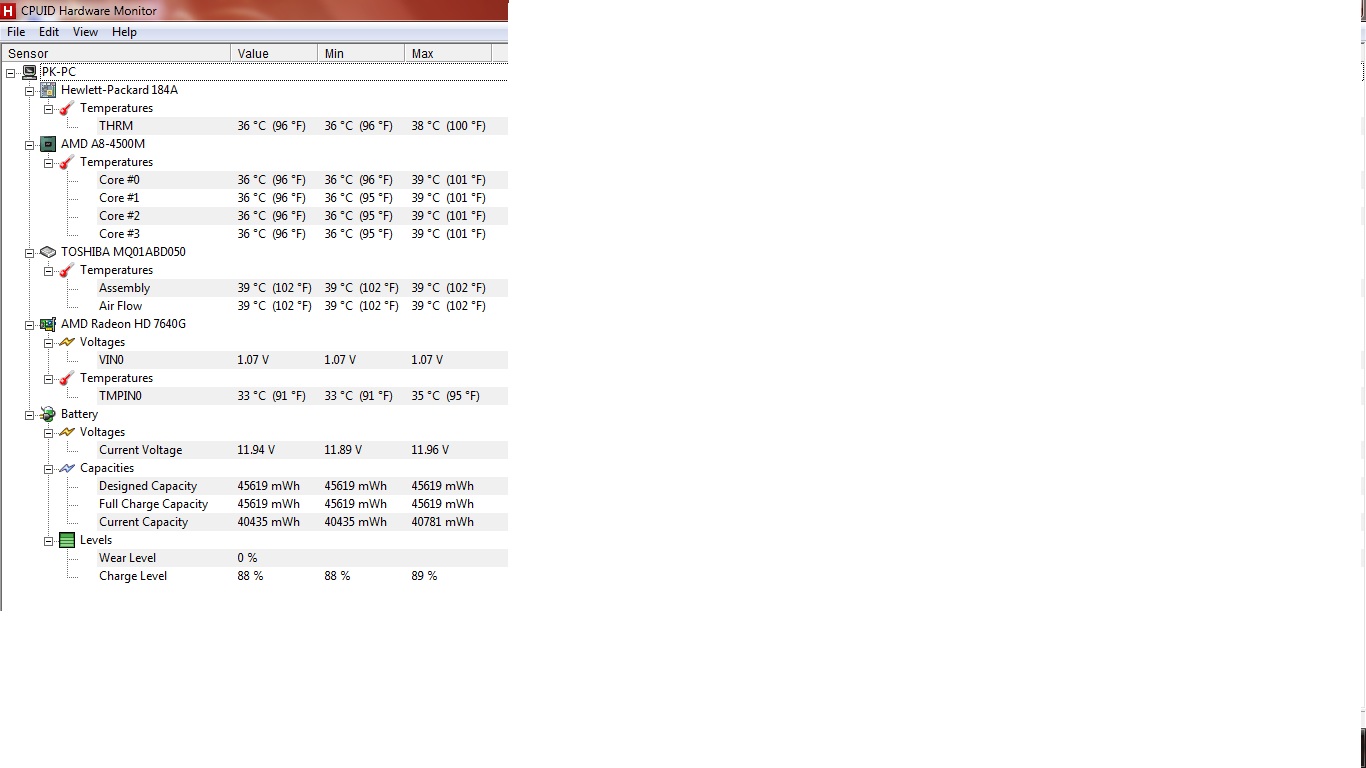

I am sorry but I am very knew to this software, can you tell me how you were able to make out that just the discrete GPU is enabled by looking at that picture?
Because its showing temp of only GPU, if iGPU had been active, then its temp must be visible (HwMonitor must be updated)
