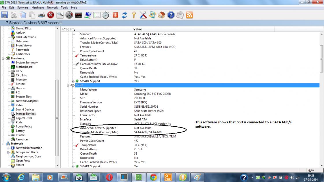

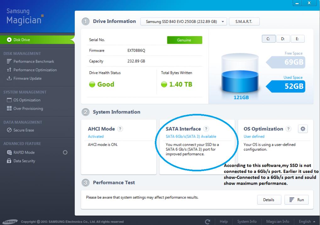

3.This is the message shown by Samsung's Software,which came with SSD-

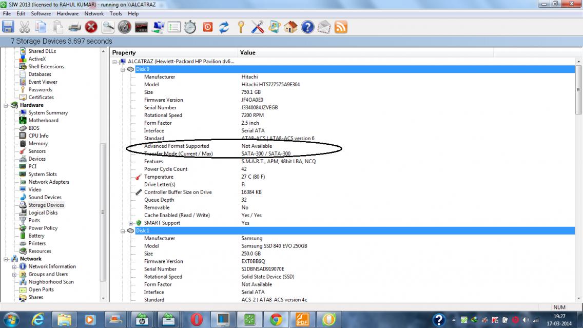

4.While another software shows this-

Try speccy.
With different software reporting different values, there is nothing you can be sure of atm. So unless it really hurts your system performance, why do you care if its SATA 3Gbps or 6Gbps. Whats the sustained/burst rate that an SSD can take btw ? Is it over 400 MBps ?

Help,what is this??
I know my SSD is SATA III compatible,what does the two things mean.......???
swiftshashi
swiftshashi
Beta Geek ;-)
[MENTION=221001]Pranav[/MENTION]
Then bro WTH is this????:razz: :mrgreen: :lol:
Conclusion
These all softwares ARE NEVER 100% correct!!!
I am now at peace,because the benchmarks of my SSD is matching with those online(which have tested in SATA III config)....So it proves,I have 2 SATA III ports :)
