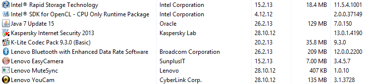

Here is the only Bluetooth driver that appeared into the Programs List after installing the Bluetooth Driver for Windows 8 x64 from the Official Lenovo India Website, Ratul bro.
ratul
How did you upgrade nickaustin bro? Did you use Windows Upgrade Assistant to upgrade the Windows 7 Home Basic or fully formatted the C: Drive and then booted using the iso that you had downloaded from the Windows Upgrade Assistant while purchasing it online?
As you have Broadcom chip, which i think has to have inbuilt 4.0 support (i think Enhanced data rate implies that), i can't help you anymore, coz broadcom drivers are different from intel bluetooth drivers, which my lappy has.. :(
let's see what nickaustin has to say about this problem..
