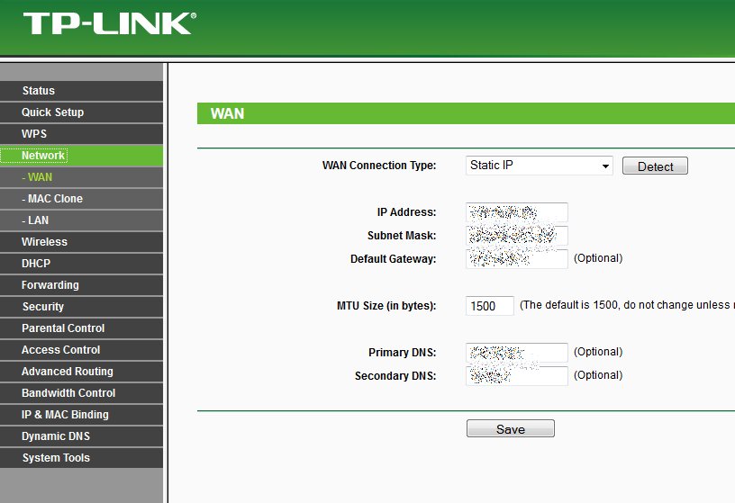

* Go to Network -> WAN
*www.thinkdigit.com/forum/attachments/networking/10899d1370716090-wifi-cable-internet-tplink1.jpg
This is where you put the IP/Subnet Mask/Default Gateway/DNS Server/Alternate DNS
You already have these values in your IPv4 settings in Network and Sharing Center Properties ( if you don't know about that I can explain ) I blurred mine just in case.

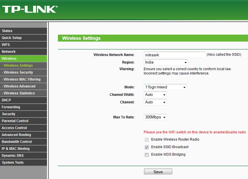

* Go to Wireless -> Wireless Settings
*www.thinkdigit.com/forum/attachments/networking/10900d1370716120-wifi-cable-internet-tplink2.jpg
I just set my Wi Fi Connection Name here, and selected the country. The rest are at default values.

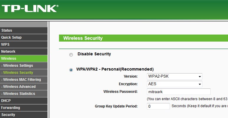

* Go to Wireless -> Wireless Security
*www.thinkdigit.com/forum/attachments/networking/10901d1370716149-wifi-cable-internet-tplink3.jpg
Set your Wi Fi Connection password here ( mine is same as my connection name, don't get confused, you can enter any other value here)

@mitraark, aren't you toooo casual about your wireless security settings????
Of course if that is for a demo purpose,then all is well.
EDIT : Big Mistake, won't happen again, see link in the comment below.
