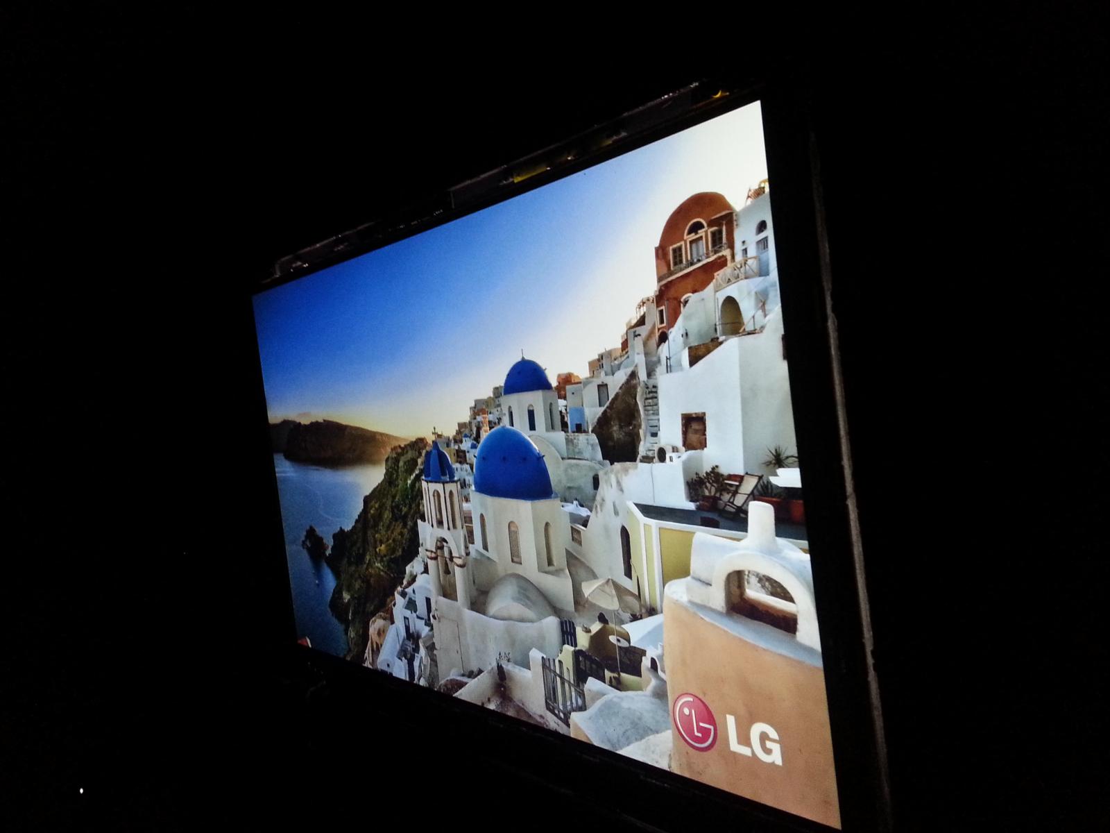

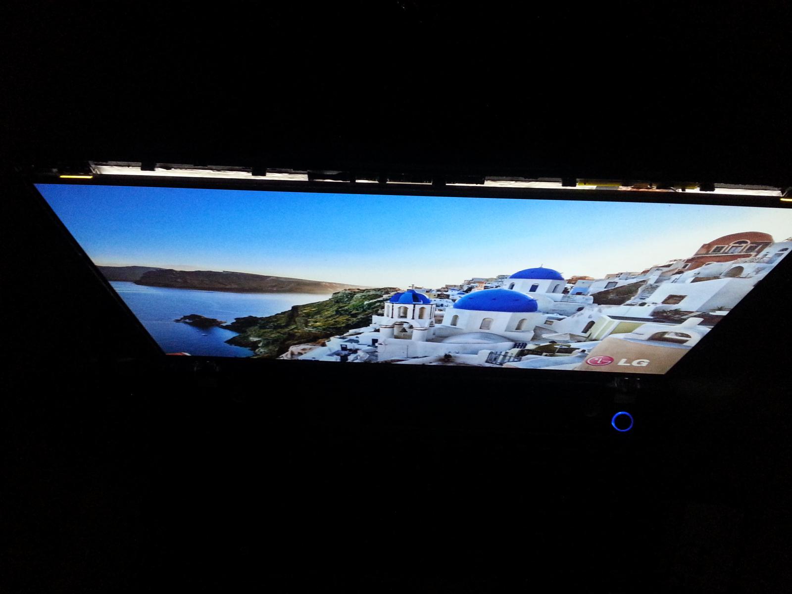

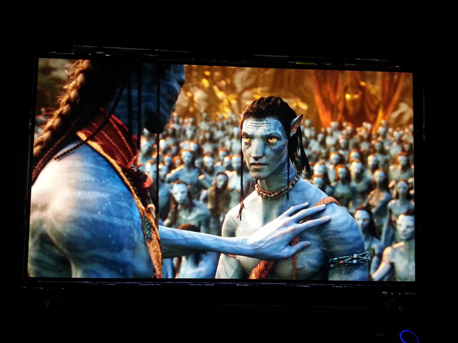

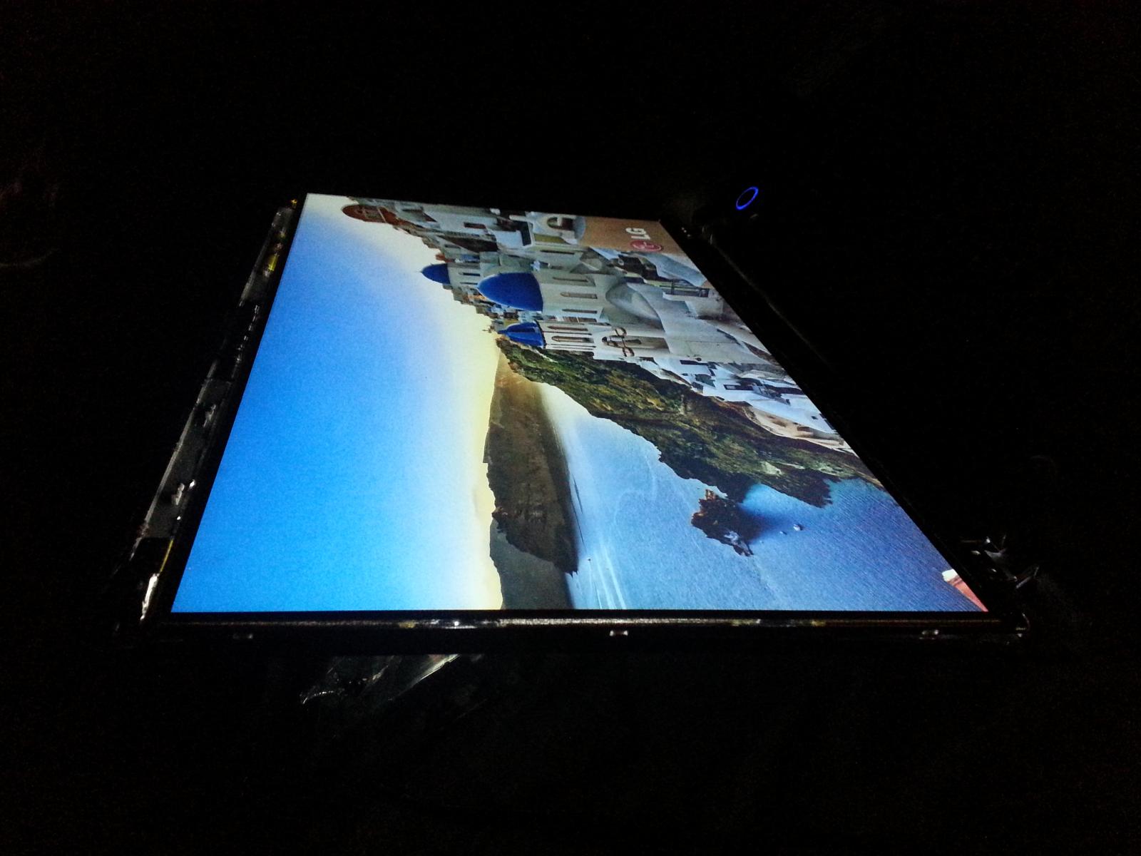

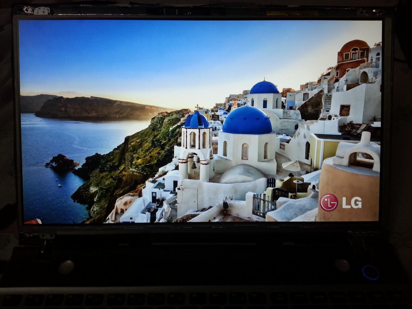

Hi,guys,
I posted here long before, but i was following this thread.
I need to post here as i made a huge upgrade to my laptop and i need to share
You guys know our laptop is good but not perfect,the area that was annoying me was the screen,some you guys may disagree but thats my opinion. That display is one of the worst,i mean i've seen many screens and this has worst of everything contrast,pathetic black levels,brightness,colors you tell me everything was bad.You can the notebookcheck review of the same.Our's comes with a 1600*900 ltn156kt06-801 display.
Now i wanted to upgrade to a 1080p screen and after a long research:)...i found out, for that you need a compatible lvds cable and one from NP550P7C,the 17inch version can handle 1080p and mind you rest of the specs were same.
AUO B156HW01 V.4 was the favourite.its a TN panel that came with xps15 l501x.......and then i came to know of IPS screens from LG which also have 40pin....one of the sceen from that series is sony vaio s15..
Now i dont know if anyone tried IPS in place of a TN even in notebookreview forum,i posted there also.....they speak good of B156HW01 V.4 but its viewing angles are still TN....for me that's a NO.....
so........i tried my luck and i bought one and the cable..HUGE RISK.......BUT
............ IT WORKEDDDDDDDD.....!!!!!!!!!!!!!!!!!!!!!!!!!!!!!ITS AWESOMEEEEE.....DIFFERENCE IS DAY AND NIGHT......
I used a LP156WF4 SLB5 IPS,the best of that series,which i found out after reading a good amount of notebookcheck reviews....ITS PURE AWESOME AND I LOVE IT.........
comparison of specs i collected from notebookcheck..
NEW PANEL(ips) STOCK(tn)
Maximum(brightness): 316 cd / m² 202 cd / m²
Average(bright) : 295.6 cd / m² 184.8 cd / m²
Illumination : 90% 83%
Black (lowest better) : 00:33 cd / m² 1:3 cd / m²
Contrast : 930: 1 142: 1
.it was my experiment and there was a huge risk involved......
Here's some photos took with my s3,but the pics dont show even half justice regarding the quality..i'll post more photos if i get hold of my brothers canon t4i.......PS:I hvent put the bezel around the screen in these images...

Hi,guys,
