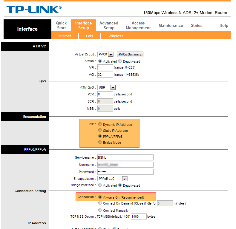

I bought TD-W8951ND yesterday and configured it using the Setup Assistant available in the CD included.
Mine is a PPPoE connection from BSNL, and it configured fine with the setup.
I used the net for about an hour, but then I wanted to change a setting in it.
The connection through my old modem required dialing manually through a username-pass.
So I went to its web configuration page (192.168.1.1) and changed it to "Connect manually" instead of "Always connected".
After saving changes, it turned off the net and since then, I'm not able to connect it again.
I re-configured it through the CD after a factory-reset but again, it wouldn't work.
The connection type is now set to "Always connected" but still nothing happens.
Tried to troubleshoot it and here's what it says:
Now I'm using net through my old modem. Please help.
1st error:for bsnl connection vci value is 35 not 32.
2nd error:"Connect manually" option in pppoe mode means you have to click on connect button in modem settings---status---device info page & not from pc.
3rd error:to connect manually from pc you have to use bridge mode instead of pppoe & create a dialer in pc.in bridge mode you can not use net on more than 1 device simultaneously meaning if you dial the connection on desktop then you can not use the dialer in your laptop connected through wifi as it will give line busy error.
Done.
OK, but as I said, I've set it back to "Always On".
Still no luck..

The ADSL link is failing almost every time for some reason. What are your ADSL parameters for the old modem? Annex? ADSL2? Etc. You can find it on the link status or equivalent page for the modem.
no wonder you are not getting connected.you have activated all PVC's & 2 of your PVC's have have same vpi/vci value.disable all pvc except PVC0.after doing all this make sure your pvc summary page looks like this:

Go to Interface Setup > Internet,
there disable every PVC except PVC0.
*i.imgur.com/AQR8M9L.png?1
In my case, I have PVC0 disabled. You should enable this PVC and and disable every other.

OK I tried to put all PVCs off except PVC0.
I don't know why its showing status "N/A" for PCV0 even if its on.
Then I tried to turn on only PVC2 instead. Its status was clearly shown.
Still no net.
But I found something interesting in Maintenance > Diagnostics
This was the same for PVC2 also.
go to settings--maintenance--sysrestart & select restart with factory default settings.after restart repeat the procedure manually by first disabling all pvc's except pvc0(confirm by checking pvc summary page) & then configure pvc0 by entering vpi/vci values & username/password in pppoe mode(don't change any other setting).do not use the cd setup assistant this time.

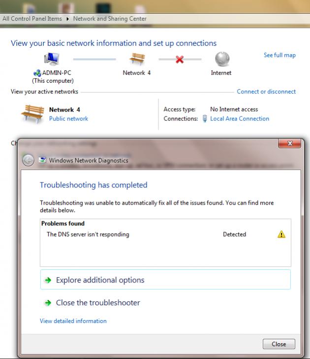

C
connoisseur
Its showing the IP address but I still can't access any websites. The taskbar still shows No Internet Access:
Its getting really irritating now.
And you know I just checked it, net is working fine on my mobile using the wifi !
Checked my mail, used whatsapp etc.
Its as if my pc or the modem is trolling with me :-?

if net is working fine on mobile via wifi then problem is with your pc lan settings.in your lan adapter tcp/ip v4 settings set option to get ip address/dns address automatically.
Vignesh B
That means, your PC is trolling you. :p
1. As already stated make the PC automatically detect the IP & DNS. If it is already like that, make it like :
IP address: 192.168.1.10~192.168.1.100
Subnet mask: 255.255.255.0
Gateway: 192.168.1.1
DNS: 8.8.8.8
8.8.4.4(Google DNS)
or 208.67.222.222
208.67.220.220(Open DNS)
2. Try alloting your PC a static IP in the modem.
