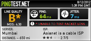

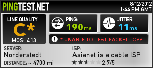

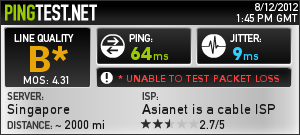

I'm from Kerala and it's the same here too, somehow all BSNL Broadband peeps are getting 250+ pings, while a local ISP, Asianet gives me pings of 70 - 90 to the same server. The jitter and packet loss is also high for BSNL when compared to others. BSNL is not at all suited for gaming purposes it seems :(

This is Asianet, a local ISP from Kerala, while BSNL gives 300+ pings to Singapore and 450+ to European servers...
