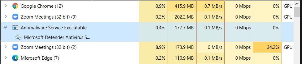

Help me, this shi* is f**king my pc
As you can see, this antimalware thingy, it is a component of windows defender. Usually this would scan the pc once a month and not take more than 2-3hours and end up with a notification shouting "No malware found" But now since monday, this is not going and instead making my pc very slow. I didnt face any issues in zoom but today i was giving a important presentation and due to this shit taking up resource(might seem very low usage, but is actually having a very big impact on performance) the slide, even wthout any of fancy animations, was lagging in simple slide change.
Any idea how to stop this? As I said earlier, this came occasionally in a month and yes, it did fu**ed up my pc even then but this time its been a week and it has not gone, and this whole week my p had been lagging like hell

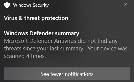

Update on it
After approx. 3 weeks of scanning it shows this
Why scan 4 times?

No idea but MS windows bugs are not usual ones in many cases. Also I fresh installed 21H1 & that seems to have solved this issue for me but I think in my case it was probably because of some windows update corruption issue(used dism command to free up some space & later windows update stopped working which I somehow make it able to work again but it probably broke something in windows during all this).
