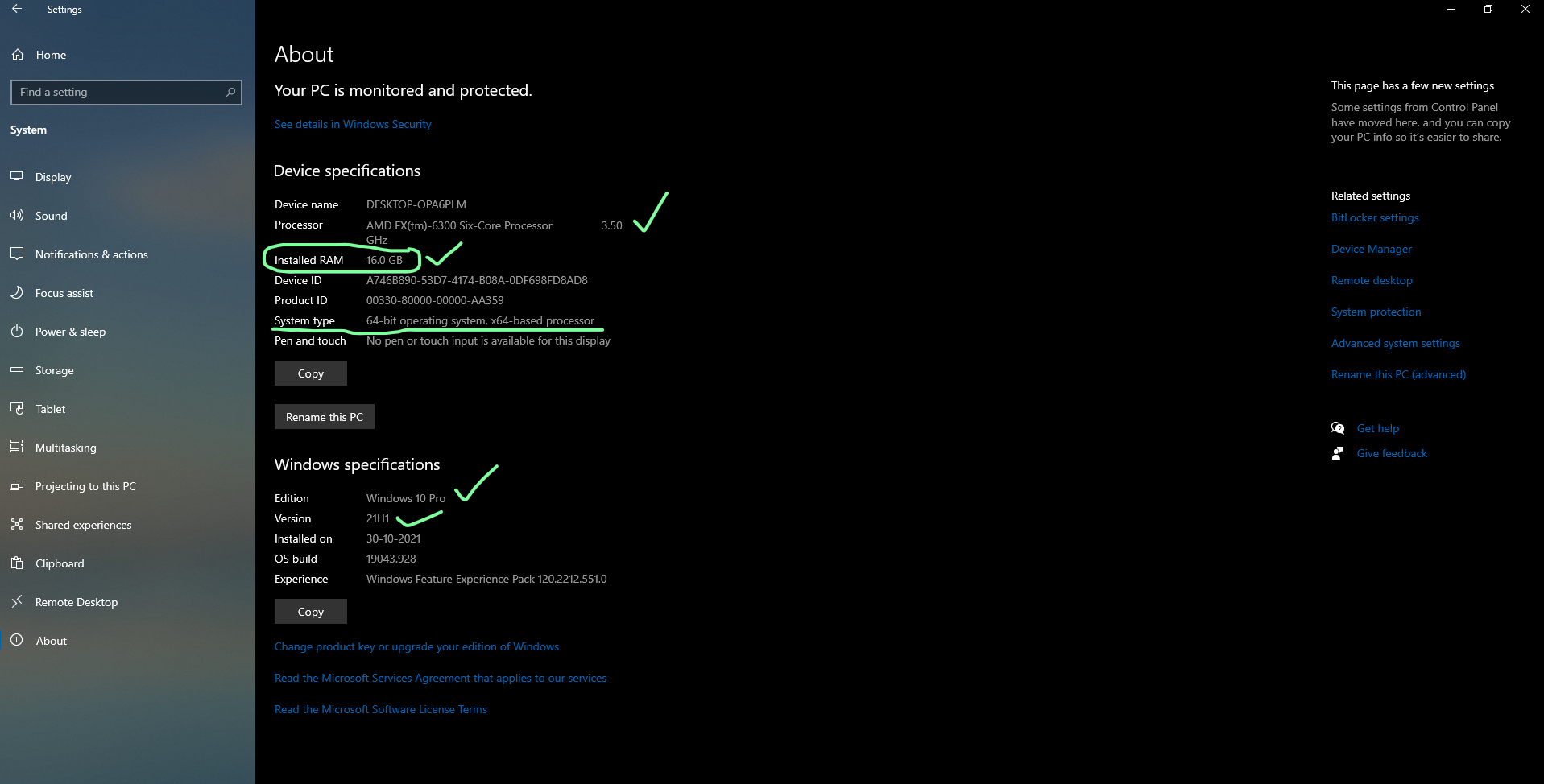

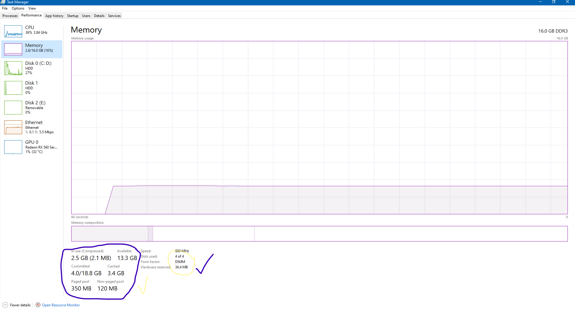

How I came back???:--->

10). REINSTALLED WINDOWS-10(64-bit) PRO AGAIN.
VIOLA!!! It works.

So, it was Dust or incorrect placement of modules.
Dust. Just had to brush it off. As for RAM modules, each of the 4RAM sticks is from CORSAIR with the same frequency /latency configuration.
