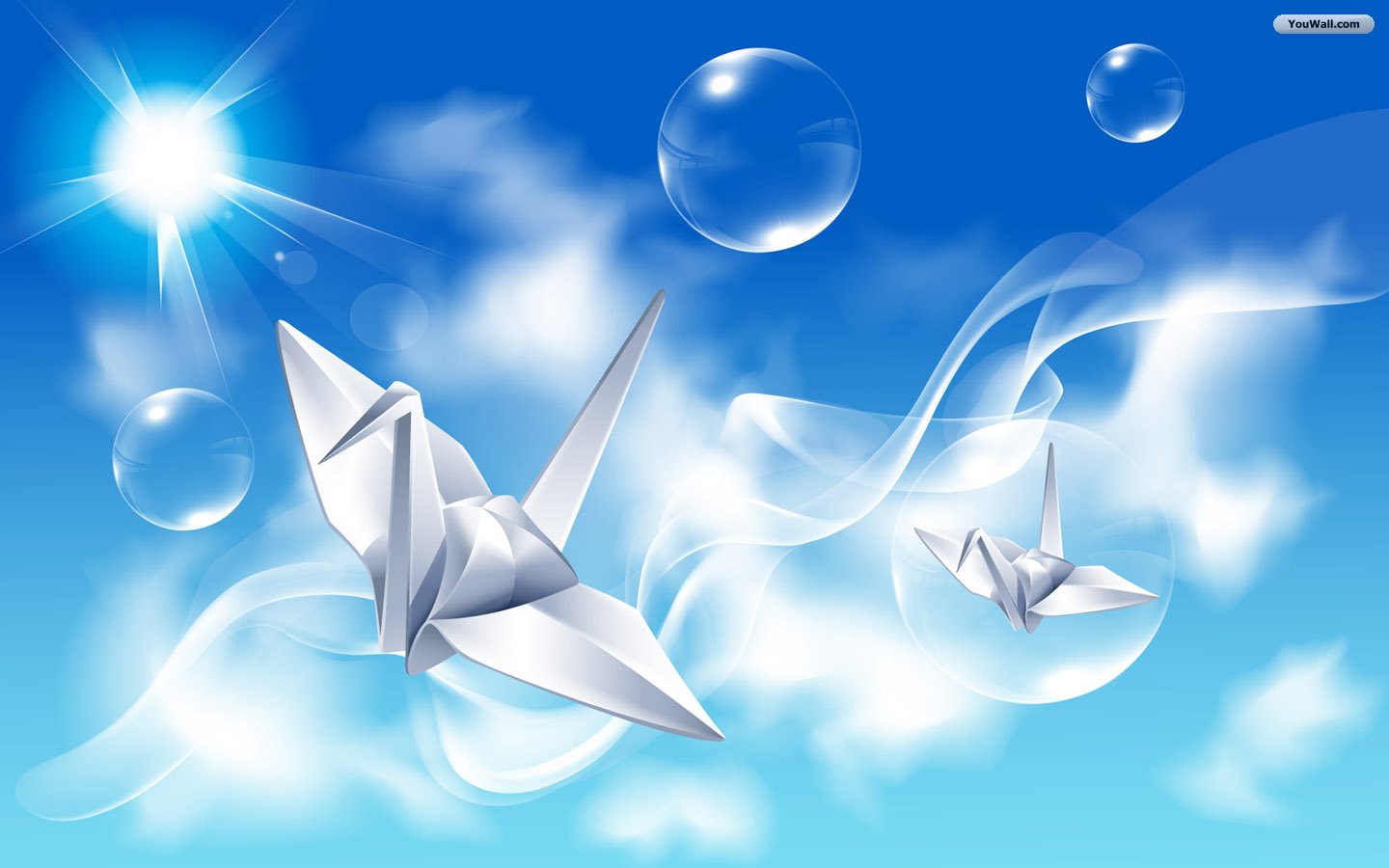

i 've attached the images of how the original wallpaper looks like and how it appears on my screen.. distorted screen.JPGoriginal wallpaper.jpg

As far as I can tell, I used to get similar results in win 98 when i would change the colors to 16 colours in the display properties window. Could be a windows palette setting or a driver setting. Memory corruption would also distort the screen..

^^ I faced similar issue because of a faulty ram module - so whenever intel gfx driver file ( ialmnt5.dll ) stopped working the screen would look like the pic Op has posted ... but the issue OP is facing must be related with the gfx card/PSU/Ram and gfx driver - also Op can try a fesjh windows installation and only after that install new driver to be free from any kind of driver related issue.
