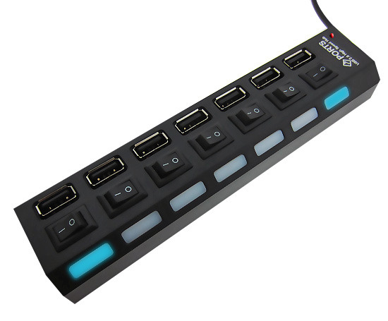

same problem with me, my 4 back + 2 Front ports are in use. And i want more ports. I've bought a low cost ENTER USB Hub 4 ports for Rs.100. But when i connect 2 pendrive or printer cable its wont work. :( one port work at a time, sometime i get error : "not recognized".
So my question is that are all USB HUB works like this? :(
what about this ?
*i266.photobucket.com/albums/ii249/atthershabbir/Others/7port-1.jpg
My MB model : ASUS - Motherboards- ASUS P5KPL-AM/PS

I had a similiar one , they had no issues. But never tried more than 2 devices at a time.
