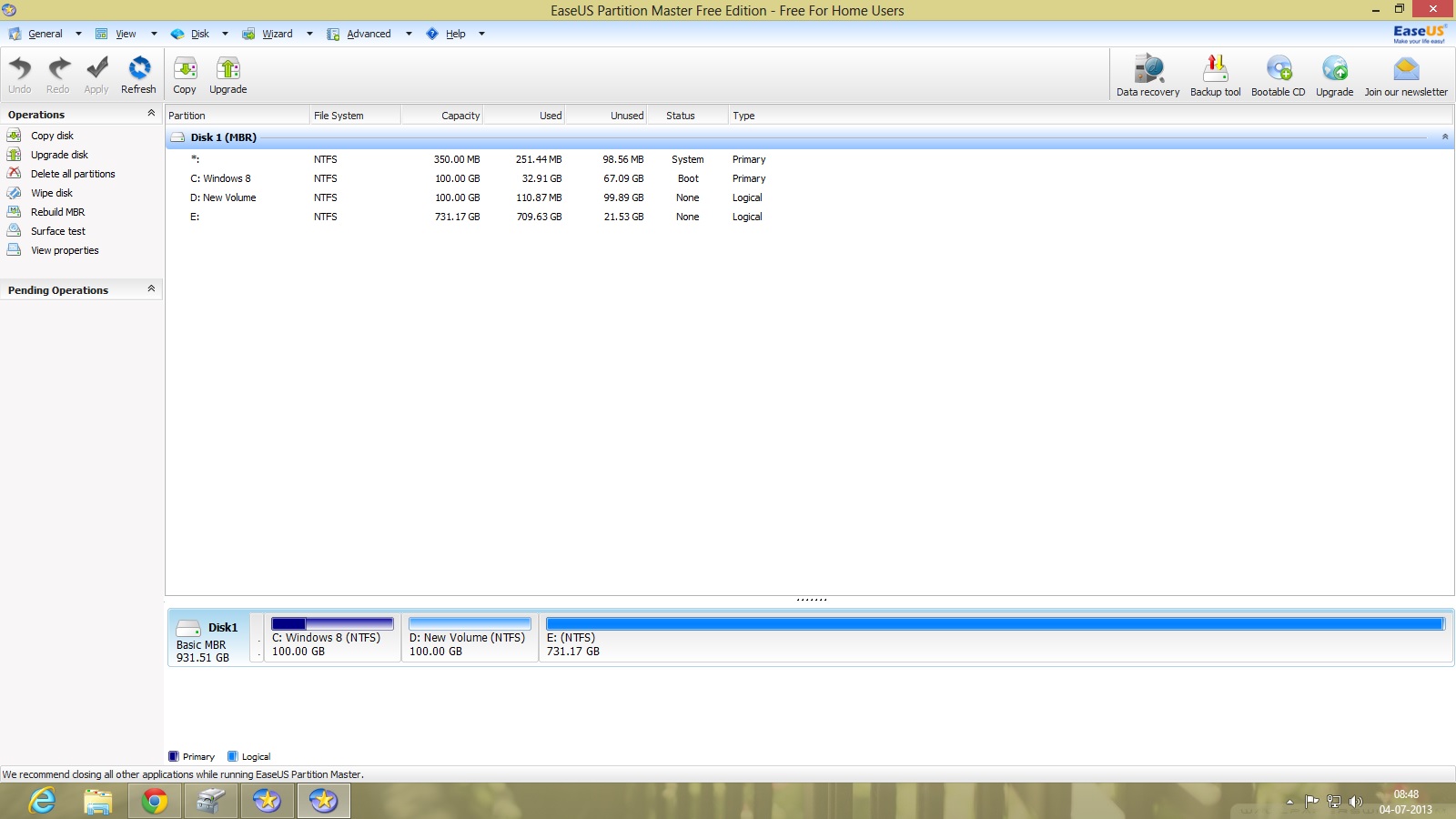

Thank you Guys ....EaseUS worked like a charm here is my new Basic Type HDD EaseUs.jpg
I had backed up important documents before doing it and the entire process was completed within 3 mins.More importantly there was no data loss:lol:
Now Only drive C is reported as primary type(as in the image uploaded) and Drive D and E are reported as logical......Can I convert those drives as primary? Is it necessary to convert that new volume into primary to install another OS like Ubuntu 13.04?

After conversion Only drive C is reported as primary type(as in the image uploaded) and Drive D and E are reported as logical......Can I convert those drives as primary? Is it necessary to convert that new volume into primary to install another OS like Ubuntu 13.04?
