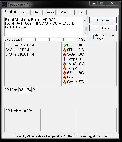

hey i got my laptop serviced last week and now i checked my temperature this was taken 10 minutes after startup is this normal or something to worry aboutView attachment 14135
depends what component, and yes 98 is high for any component.
Those are perfectly normal temps, You won't have to worry till they reach 90s.
The 4th gen i7 m has a safe temp of 108 degrees, if my memory is correct.
