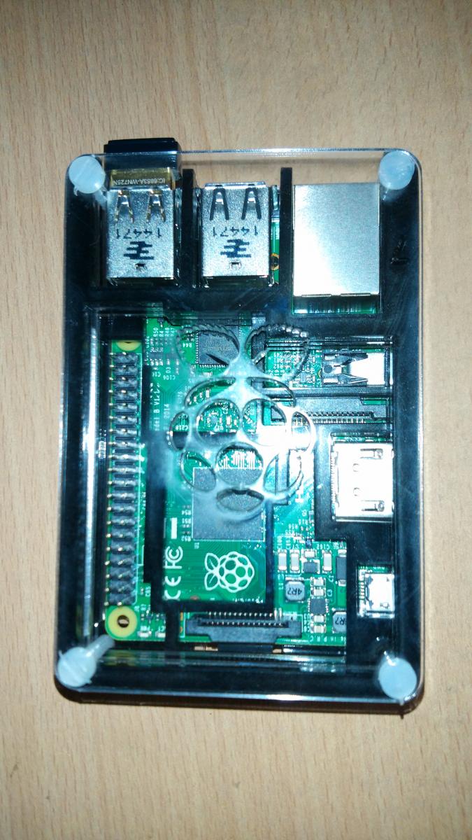

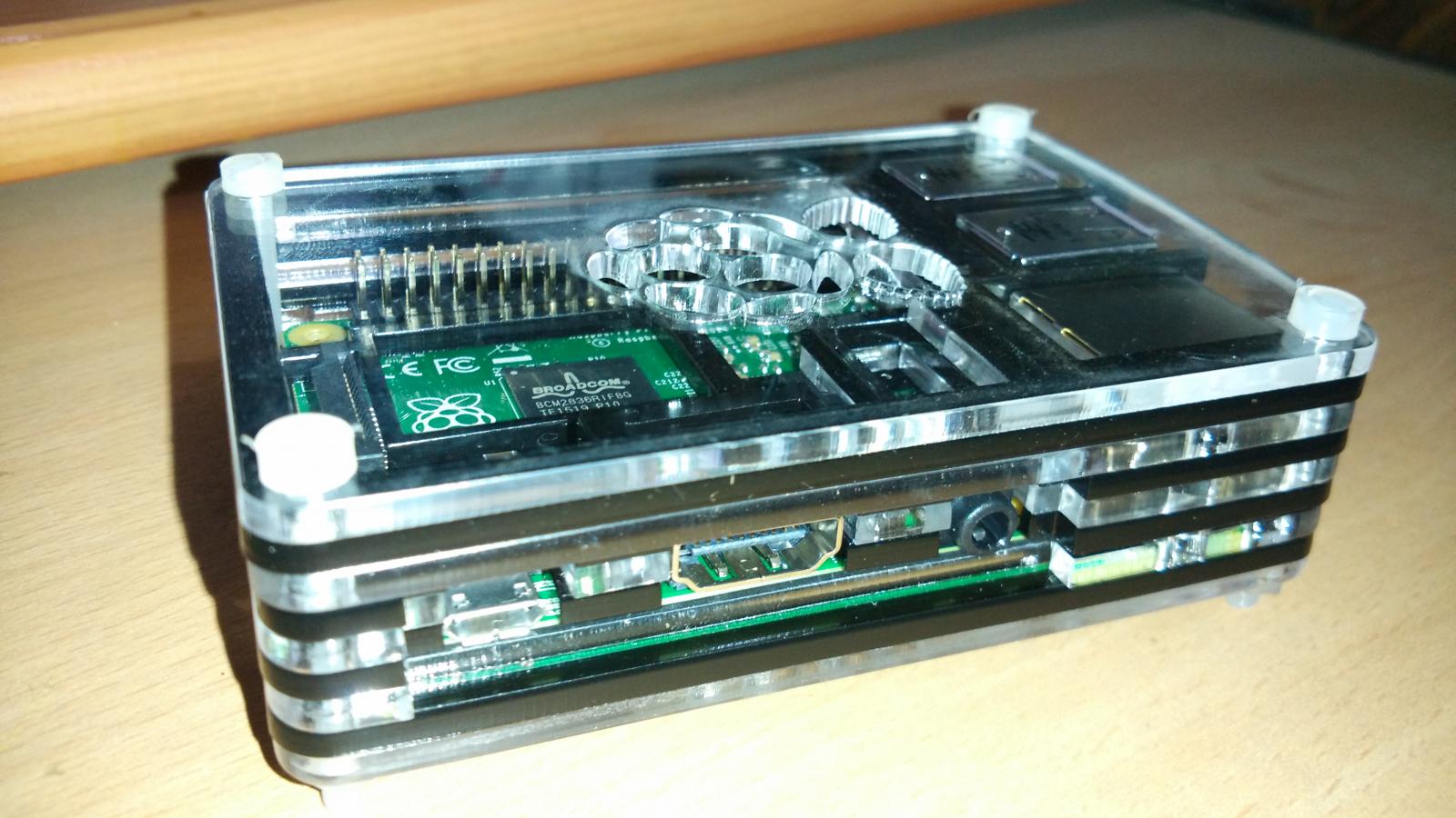

Got my raspberry pi with the case today.Here are some pics:
There's one problem I am facing.
When I attach my USB 3.0 1TB WD My Passport(ntfs formatted) to it,The red light of raspi goes out(even though it can be accessed through SSH) and my disk doesn't show up when I run fdisk,so I am not able to mount it.Is it because of power issues.I can access my pendrive just fine.I am powering the raspi using a Samsung 2.0A charger.Should I use a powered USB HUB?Please guide me in this regards.

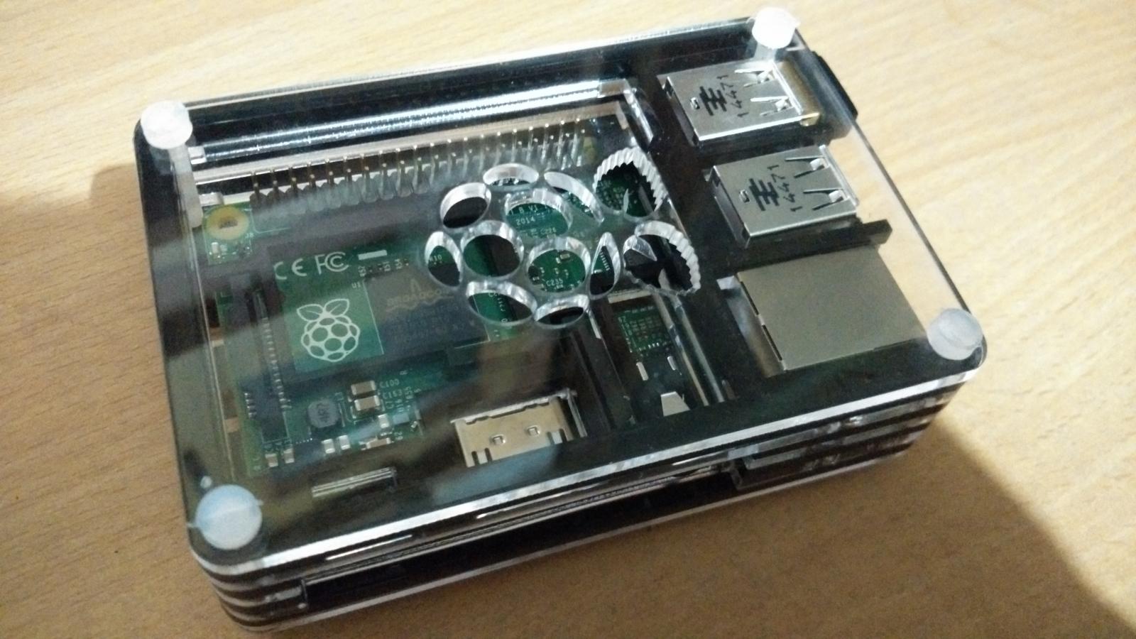

Yes, it'll be better if you use a powered USB hub.
