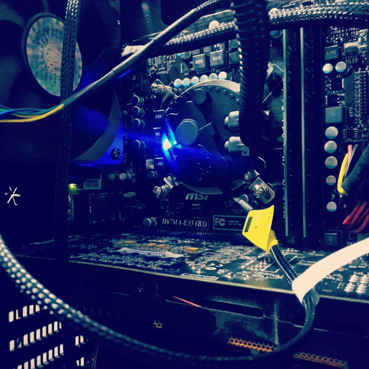

SO here is the final result. I took my mobo to the Service Centre and they replaced it without even checking (though charged me 500 for the physical damage I had caused to the sata ports :p) and I bought a CM Seidon 120XL Liquid CPU cooler after some thoughts. I came back put up the new mobo and the temp was still in 80s. Installed the new cooler and it dropped to less than 40 instantly. Conclusion - Stock Intel CPU Coolers suck big time. Lasted me just around a year.
Here are some pics of the new cooler and the inside of my cabinet.. :D.. IMG_20130419_162502.jpg
Here are some pics of the new cooler and the inside of my cabinet.. :D.. View attachment 10071

You bought a liquid cooler for a i5 2400 ? Okay....
Congrats though. Cabinet pic looks good :razz:

Thanks everyone for your help n I'm not planning to Oc the processor in any way. Not possible. Just thought why not buy a good one if you're buying. And I made the right choice. The games which used to stutter a little don't at all anymore. It was coz of heating issues. Also my max temp while playing crysis 3 at ultra is 50 without lags. So I'm pretty content with it.
