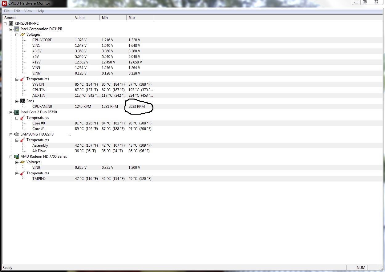

I did not applied any TIM I just opened & cleaned it ....... although i have purchased Arctic Silver 5 Thermal Compound 3.5 gram online & will be arrive to my place by evening .... But now after seeing the temperature b/w in ideal & load am starting to suspect that the motherboard is not able to increase fan speed according to the cpu temp. The fan can run on 2000 rpm as i have high lighted in the picture below. I have also used FAN speed software to increase fan speed but it sis not work.
Any suggestion to the problem is highly welcomed .......

also I think the +12v reading is bit high.

are you using your pc without applying any TIM on the processor?

I am using Index Smart 450 Watts P.S.U .......... Will That help .......No i did not remove the old TIM on the base of the CPU cooler just cleaned the aluminum & Mounted it again as it was before also i did it today well to see that it been 5 years since i had buyed my PC ..

to solve your problem regarding temperature, YOU HAVE TO APPLY THE TIM ONTO THE PROCESSOR CAREFULLY and mount the the HSF. I dont advice you to use your pc with little TIM or without TIM .It can damage your pc by over heating.You should post screenshots after applying the TIM. That will lower the temperature in idle and load.
Ofcourse changing the psu wont solve your temperature problem.But HERE is a link you should read
*www.thinkdigit.com/forum/power-sup...89-power-supply-blacklist-thread-newbies.html
So it is better to have a good branded PSU to be on a safer side.
Regarding the +12v issue, ATX v2.3 specification by intel suggest that the voltage on +12v should be under 5% =12.6v max and 11.4v min. Use wikipedia to find the details.
