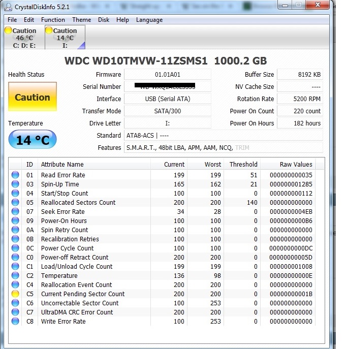

try on another system(preferably a laptop).maybe issue is with insufficient power.anyway whenever it gets detected install crystaldisk info & use it to check hdd health & post a screenshot of S.M.A.R.T values table here.
Hi whitestar thanks for the quick reply,
here is the screen shot.

RED ALERT!!!!!! Backup your drive ASAP.....
Backup your backup drives ASAP :p ;) :(
1B pending sectors means 27 in normal decimal system.though it is not such a large value still it is worrisome.try writing something to disk & if it completes successfully check if this value changes.if it does again post the screenshot.
