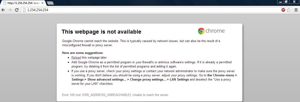

i am a tikona broadband user. i have a wired ethernet cable attached to the back of my laptop. i have to login to tikona's website everytime i log on to my laptop after a while. i use dual boot , windows vista home basic 32-bit & ubuntu 12.04 LTS.
In Windows Vista, when i plug in the RJ-45 then the OS connects to tikona's network successfully but doesn't get internet connection. it shows a red cross between between "Unidentified Network" and "Internet" & a green tick between "MyComputer" and "Unidentified Network". The login page , which is 1.254.254.254 doesn't open. Chrome says "Address unreachable" & IE "address not valid".

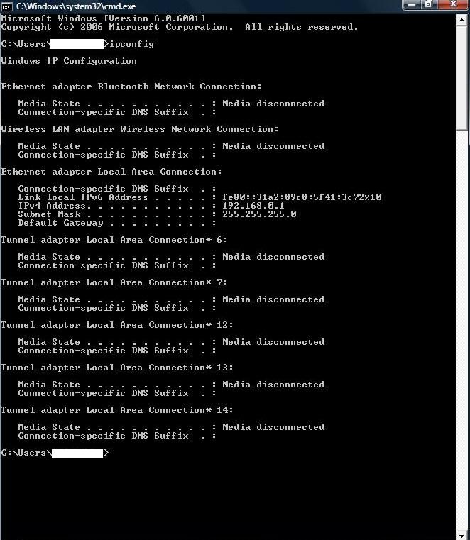

this does not help.when asking questions about network connectivity issues first thing to do is post the results of running ipconfig /all in command prompt window.
i don't know about tikona login system but you mentioned that login page is 1.254.254.254 & your pc ip address is 192.168.0.1 with no/blank gateway which in my opinion is definitely wrong.see this:
Is there IP configuration for Tikona based LAN? | Grievances |Tikona Broadband Forum
You have to keep your IP settings as,
Obtain an IP Address Automatically for IPv4
& remove check mark from IPv6

that worked! many thanks to you man...
