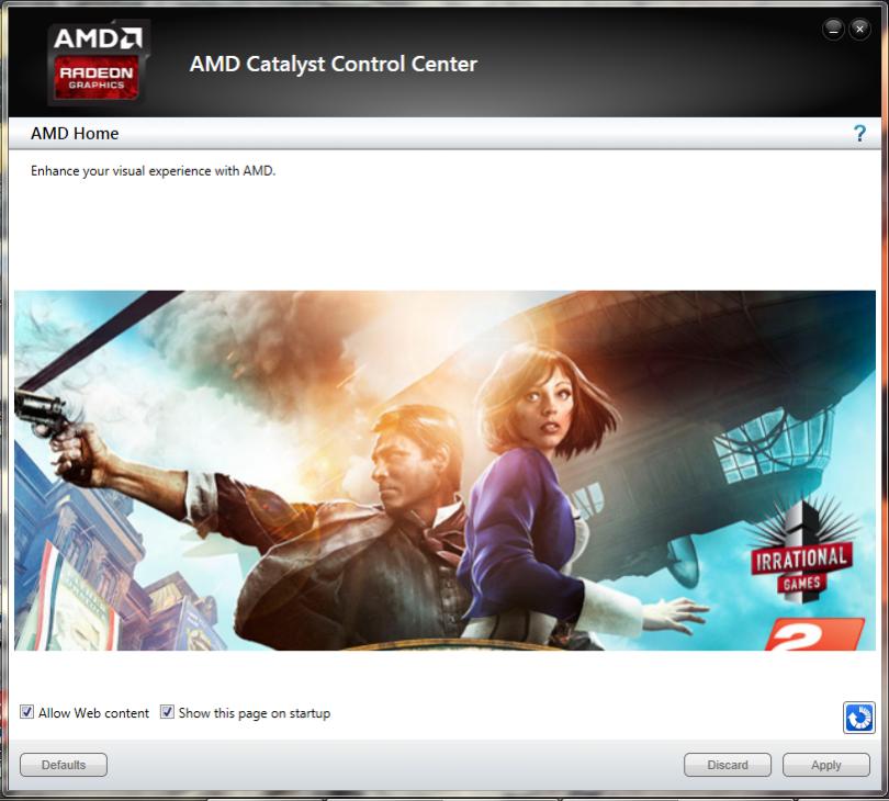

I have Radeon HD 6770 with switchable graphics..just now installed this beta version 13.11 and now i cant Fkn see the switching option in the Confirgure swictable graphics window..just some random poster sh1t is displayed..:shock:

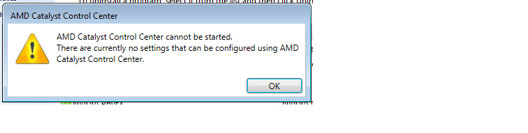

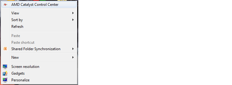

Now i'm getting this error screenshot when i launch CCC. and my desktop resolution has changed to the basic display and in the right click option there is no option for configure switchable graphics View attachment 12767..so please help me out..

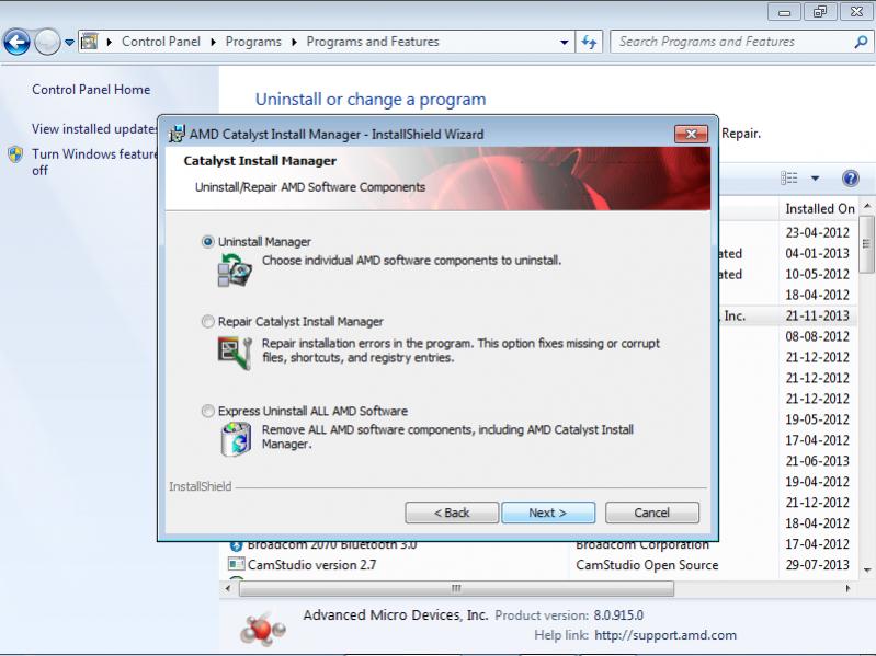

Can i uninstall the 13.11 Catalyst control center..which option shall i use uninstall manager or express uninstall all amd software? see this View attachment 12768
