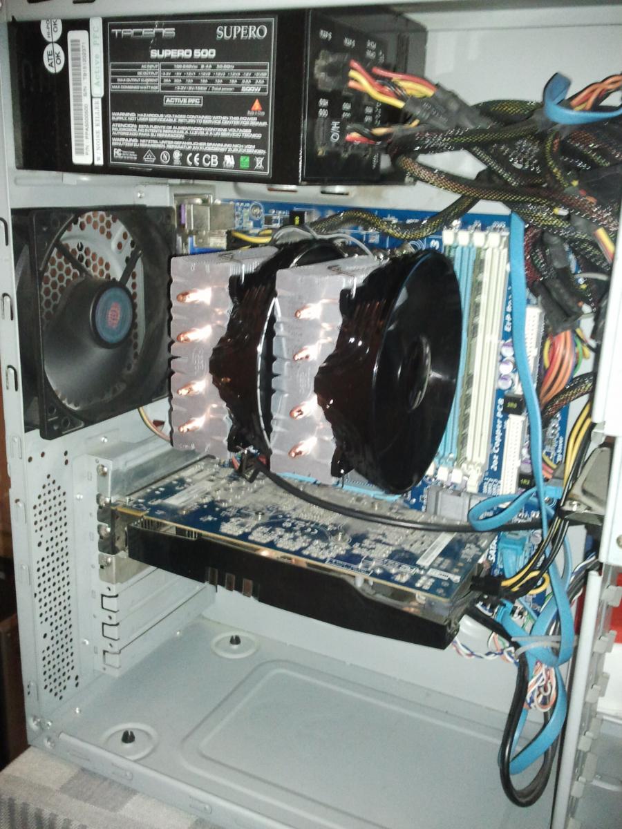

Hyper Evo 212 is not available. Instead I bought Deep Cool Frostwin which cost me Rs 2500 at Nehru Place.
Though slightly different than Evo when it comes to installing it I was able to get an idea from a YT video and get it up and running in a couple of hours.

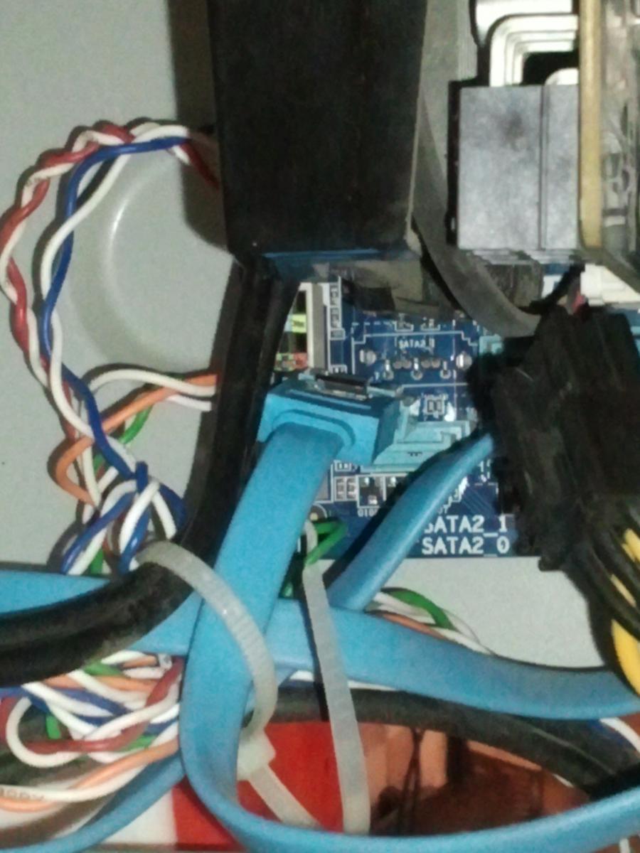

The only thing that I couldn't fit back is the Sata 2 thingie with 7 pins sockets when I tried to plug it into the 7-pin on the motherboard it just wouldn't go in.
So I left it like that - anyone know how to put it back please suggest how.

Now it is running in a super silent mode! I will try some games in a day or two and observe how it goes.

Ice Pro looks nice especially with LED but Frostwin has dual fans....I prefer performance and dual fans over nice looks. Besides I went to the Deep Cool distributor and he had much higher models after Frostwin. So it also depends on what is available in the market, considering the fact that Evo 212 such a popular model is not available.

True with AMD as I experienced - it was becoming impossible to sit next to the computer because of the high pitched airplane like sound. But an after market cooler like in this case is the answer. Now the computer is super silent - even the tell-tale sound of the fan starting when the computer is switched on is gone :)

It's in my post #22 line no. 5, though it is difficult to take a better picture basically that connector has 7 holes and should fit into 7 pins on the motherboard. When I disassembled it I had drawn out each connection so I am sure it is this place where the connector plug has to go. But the pins are so thin and feeble that the connector is just not going in - I am sure there is a way to do it. On the other hand the main power button at the front of the chassis is not working so I switch on the PC with the help of the smaller reset button , not the most ideal way to do it. I don't want to try to fit it in too many times (have tried many times already) because the pins will become crooked and may even break.
Is the connector not being in place related to power button not working? I presumed so because that was the only missing piece after assembling the system back after fitting the new cooler. Because if it is something else which makes the power button work then I can apply that resolution. Please help.

Pic attached.View attachment 9743

congo for the purchase!! looks great! :)
btw, you need cable management.
I've looked at the pics of post no 22 beofre but still the whole thing is not very clear to me hence asked for a some differetnt pics, anyway is it possible for you to post the motherboard model name/no. ?

Sorry about that. The mobo is GA-880GM-UD2H. If a pic is still needed I'll open the box and take one again.

just one question .. according to the pic you posted why the Sata port on the mobo is not straight ? and there's only 3 Sata port on the mobo instead of 5 ?
