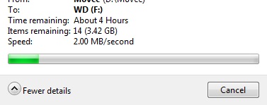

I have a 500GB WD harddisk, which has two partitions...as I used it for downloading thru torrents via segate dockstar. On one partition Debian (Linux) is installed, the other partitions is used for storage and backup.
Now the problem is that the transfer rate from HDD to PC becomes very low some times it drops to Kb/Sec for large files >1GB. Where as the transfer rate from PC to HDD is fine. I have tried using different USB cables...but the issue still persists. What could be the issue? Does my HDD require RMA?

Will post crystaldisk info screenshot once I reach home in the evening. I tried check disk and surface scan using EaseUS Partition master....but again the scan rate went too slow with estimate completion time going around 24hrs...i had to stop the surface scan :(

it could be that HDD is actually bad. I had a laptop HDD exactly the same way. it just went unbearably slow but never threw errors or stopped. I replaced the same under warranty.

MY WD hard disk getting Slow .. window 7 gave data recovery warning ,,
