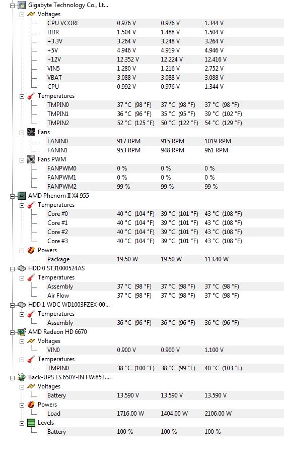

HW MONITOR i already have:

As per my understanding 3d Mark is not showing any sign of GPU dispute. Expert comments solicited.
