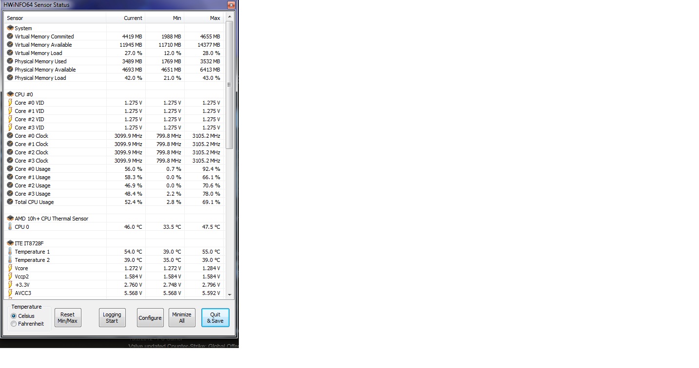

now can you post the upper half portion of the the hwinfo screen - it has infos like cpu speed / cpu fan speed / cpu vcore/ cpu temp etc. lags in games can also occur due to cpu overheating.
CarlonSamuels
CarlonSamuels
cs.jpgokay here it is
Is this a case of my CPU for some reason bottlenecking my GFX because i see no change in frames even after setting all details to lowest
And if there is some problem and i need to RMA what should i mention as the reason for RMA
Jripper
Pro/An---tagonist xD
^ That should not be an issue since my cpu is far less powerful than yours. But there is no significant bottlenecking of the gpu. We both have the same GPU.
topgear
View attachment 7384okay here it is
no .. your cpu is powerful enough to handle even 2x cards in Cf and the temp is also ok .. before go through RMA process format yur OS partition .. do a clean installation of windows .. update it and install all updated drivers .. cheek your HDD for bad sectors and also test ram modules just to be sure everything else is ok .. and as of now try running the cpu with 4 cores only.
