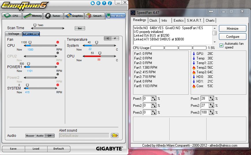

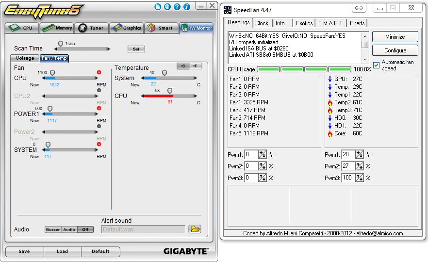

I have just changed my MoBo (as in my signature). I had to remove and re-install the processor (for obvious reason) and I used Cooler Master X1 Extreme Fusion as TIM. But I found that the temp. of the processor always remained at mid-40s to mid-50s centigrade - even in this winter. Under load this temp shoots upto 65C. It never went above 55C under full load on my previous MoBo (Asus M4N98TD-EVO) even when processor was overclocked to 3.8GHz. I have removed the heatsink, cleaned the surface and reapplied the TIM atleast 3 times but the temp never changes.
I have assembled atleast 50 computers earlier and not one had this problem - so I can say that I know how to apply TIM. So why is this problem coming up again and again? Can TIM be the culprit? Can MoBo sensors be faulty?
What should I do?
