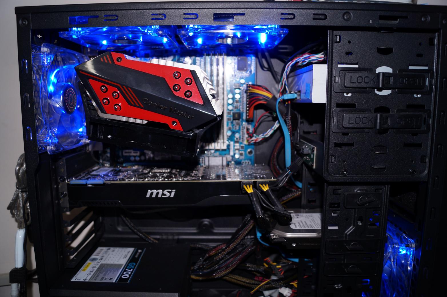

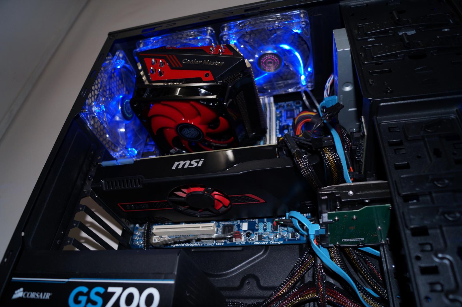

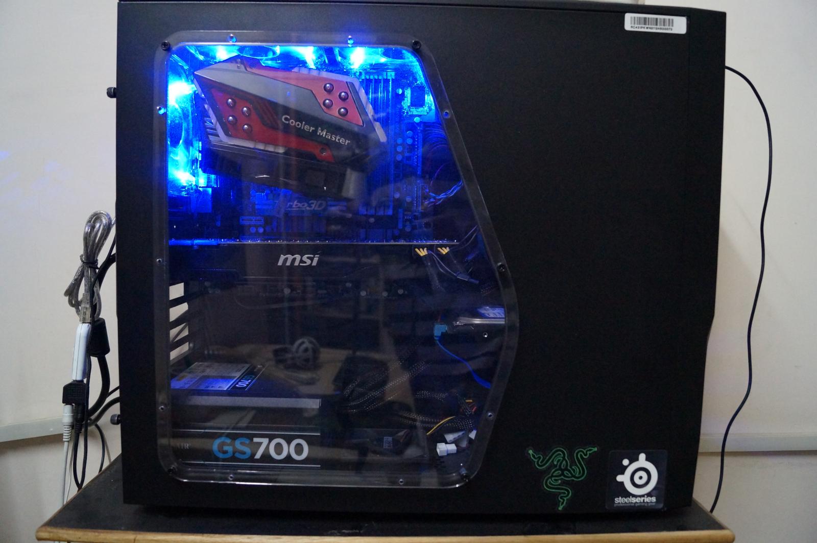

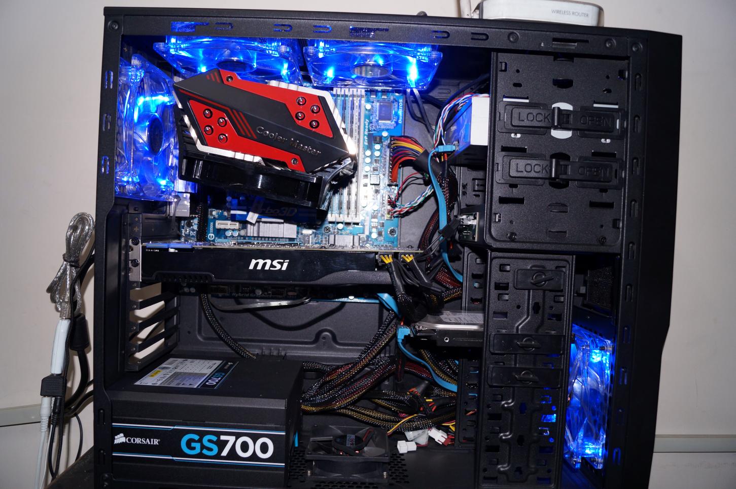

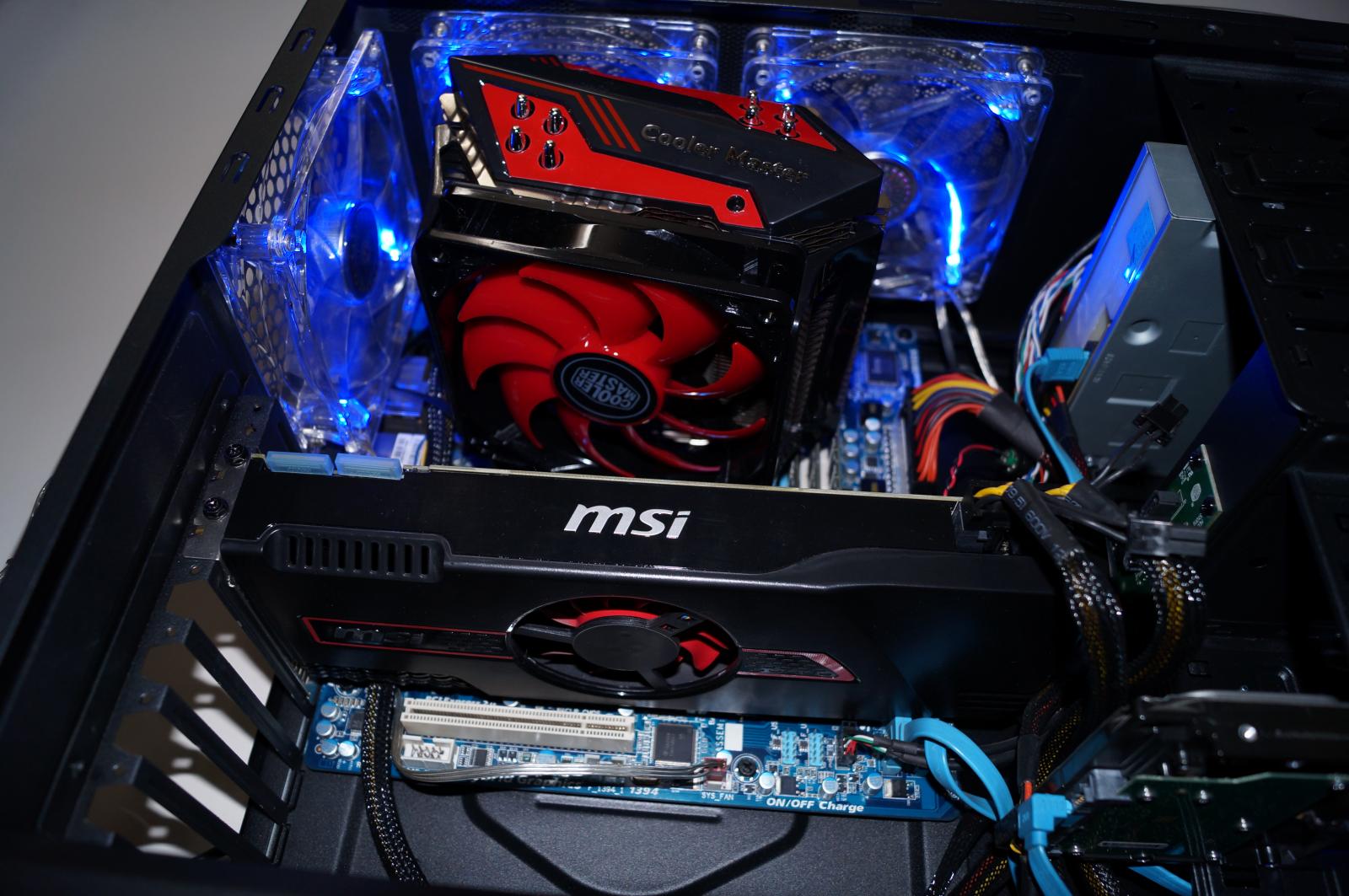

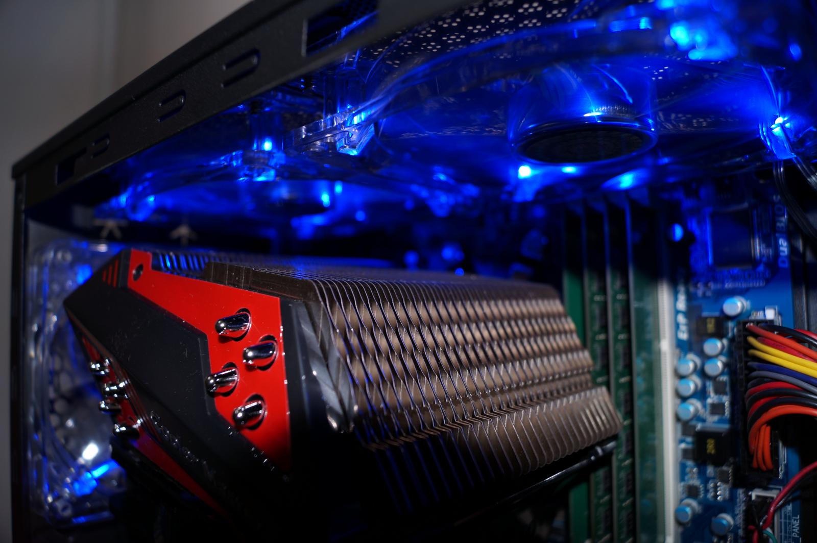

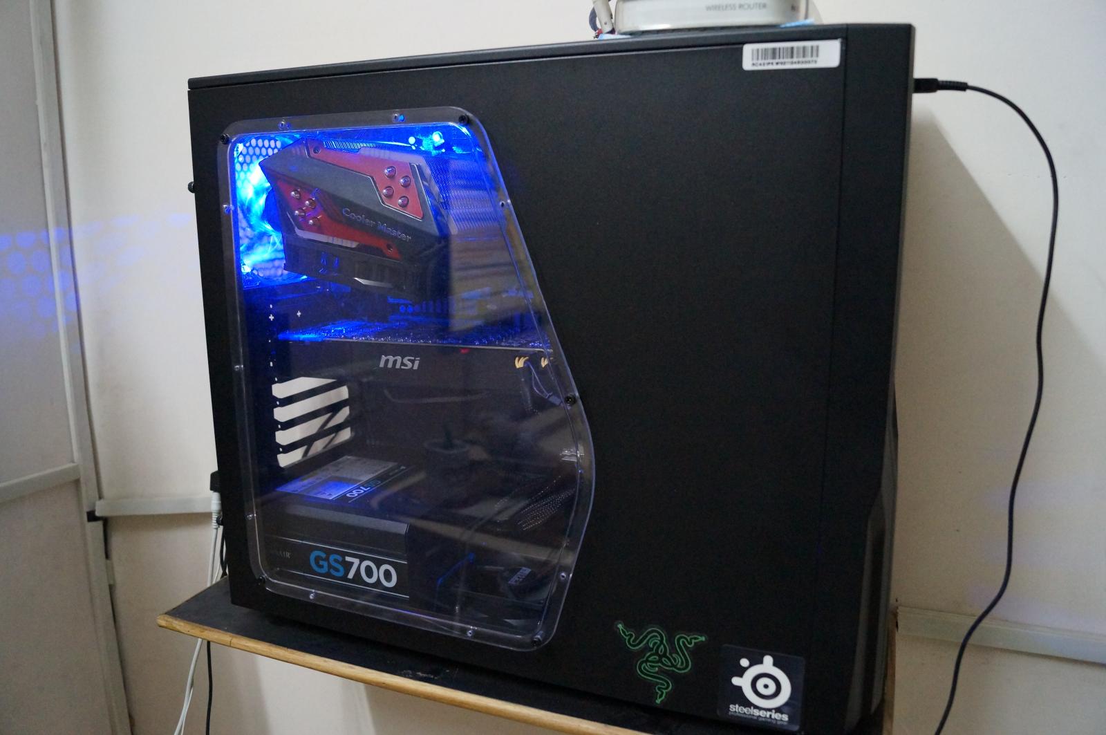

Okay.. updated my pc.. new pics...
comments pls..
I am clueless about cable management still!! :cry:
Myth
Great quality pics. Nice lighting. I prefer blue also. Seems you cleaned it recently or else its quite new.
There isnt much for cable management in the 430. Normally everyone tucks everything behind the HDD cage or above/below the OPD(s).

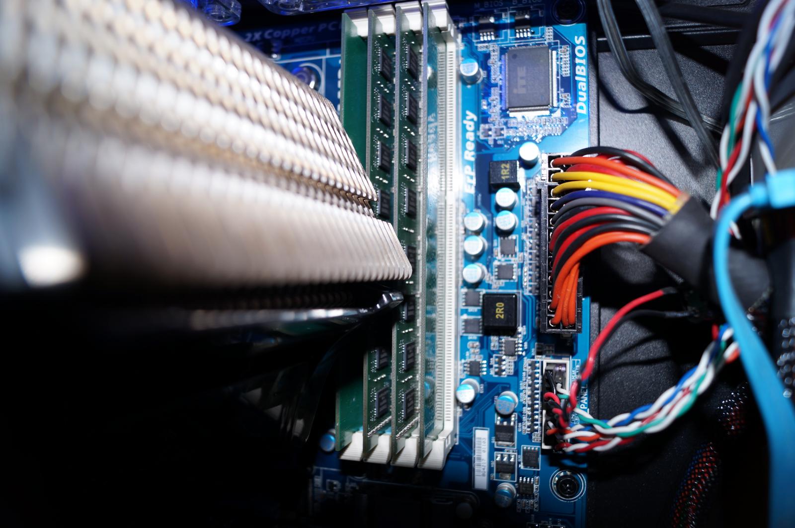

Guess so.. thanks for replying.. one thing is that the x6 doesn't fit in here..had to put it horizontally or remove the two top fans.. this way its more cool but its all over my ram slots.. so if I want to change my ram.. have to remove the hsf..
wow...the blue led's on top look nice...damn have to rework my own cabinet...its due for major cleaning now...
You are right.. I cleaned it and I always keep it cleaned and neat.. I hate dust especially on my sweetie..
