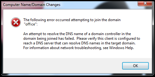

Another question is, After getting New Workstations, I wanted to connect that to the SERVER but Windows 7 could not log into domain of our server. Besides following the proper process/steps. I am able to use the printer and internet shared through SERVER though.

for second problem what exactly are you shown. Post a screenshot if possible.

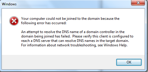

This is the screenshot of the error:
Please help me
try these:
Solved: Windows 7 DNS Error - Tech Support Guy Forums
or
Windows 7 Pro can't join to Windows Server 2003 domain server - Vista Forums
I have found a fix for me. I have had to disable or lower the NTLM security.
From windows 7, click start, type local and open the Local Security Policy
Manager.
Select Local Policies -> Security Options, in the right find Network
Secuity: LAN Manager Authentication Leven, and set to Send LM & NTLM - use
NTLMv2 session security if negotiated.

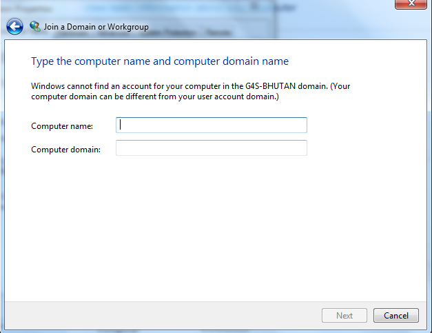

Is there anything to do with setting up or inserting IP Address in Network settings?
This is another screenshot for you geeks. PLease help me.
What am I suppose to put in these fields?
did you check the 1st link i posted in my previous post?if you did & can not understand then it would be better if you contact some person having some networking experience in domain groups(or your network administrator) & ask him for information like domain name etc.
