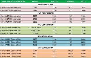

Hi All
WRT to this thread, I am unable to find AM3+ motherboard with 970 or 990 chipset.
The available option I have is to ditch AMD and buy used intel 4th gen processor + mobo. Can keep my HyperX DDR3 this way.
Have searched few fb market place and found i5 4590 and i7 4770/90 for ₹2800 and ₹7500 respectivly to replace my FX6300.
New Biostar H81 mobo extra for ₹5800. (Neheru place is nearby to my place)
I know both chips are superior to FX6300 but confused which one to get.
Will I will be getting noticable extra performance from i7's 4 core 8 threads? As i5 is almost 1/3 price of i7.
I have RX570 GPU, 16 gigs hyperX D3 ram and Lg ultra wide monitor (21:9) as of now and use my the machine mostly for movies, internet surfing. Yet to play GTA4,5, COD IW onwards, BF V, etc.
I will be relocating soon so dont want to spend Ryzen money for now.
Please advice, i5 or i7.
PFA for cpu price list.
topgear
get i5 but seriously spending around 5.8K on a H81 motherboard makes no sense. You can also find one at much cheaper at FB market place.

toshar
toshar
New to this forum
Okay..
So the available i5s are either T or S variants, somewhat inferior.
i7 3770 + H61 m/b = ₹9k
i7 4770 + H81 m/b = ₹10500
The guy has persnally suggested to buy 3rd gen coz of similar performance in games wrt price differnce but H61s doesnt come with Sata 6gbps and Usb 3.0 ports.
Now what!
quicky008
i7 4th gen looks like a better choice-its a bit more updated and also supports the avx2 instruction set that the 3rd gen does not.Btw are you getting a new h81 mobo or a 2nd hand mobo?
However be advised that the i7s are known to run a bit hot as compared to i5s/i3s etc ,hence you may have to invest in an aftermarket cooler to keep the temps of the cpu within acceptable limits.

toshar
toshar
New to this forum
I dont know why there is no repair option available here.
I met with an engineer with chip-level repair knowledge who accepted my motherboard for repair but then said the traces are burnt to three layers and any repair wont last long considering the heat generated in powering a FX processor so better to get a new one. What Mobo you have? AM3+?
Okay. I will finalize i7 4770 considering newer then 3rd gen, both of them will be way faster then Fx 6300 anyways but TBH I literally had no complaints with the AMD.
These motherboards and processors are used and pulled out from. Err.. I don't know. Seller is providing 1 month warranty on processor and 1 Year on Mobo (Either Giga or Asus). Sounds good enough.
I have CM Hyper 212X to keep i7 cool.
One more thing I want to confirm. I have never used SSD before but gonna get one now primarily for Windows drive and found SATA SSD < M.2 < NVMe in terms of speed so If I buy NVMe of 128 GB of x brand then where to plonk it or what else would be best for me.

don't get the NVME ssd as there's no slot to mount it on H81. Better get a sata SSD and you shall see noticeable improvement in boot, shutdown and overall system response time.
