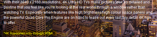

Also as per product page TH-49CX400DX LED LCD TV - Panasonic India it says 4k only supported through hdmi.
So my conclusion is that this model does not support 4k playback over usb.
Darn it. How did I miss that. Thanks a lot. So now I guess I have two options:
