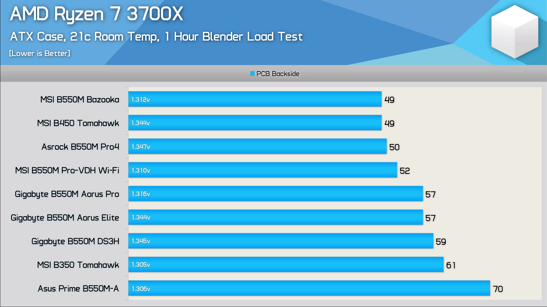

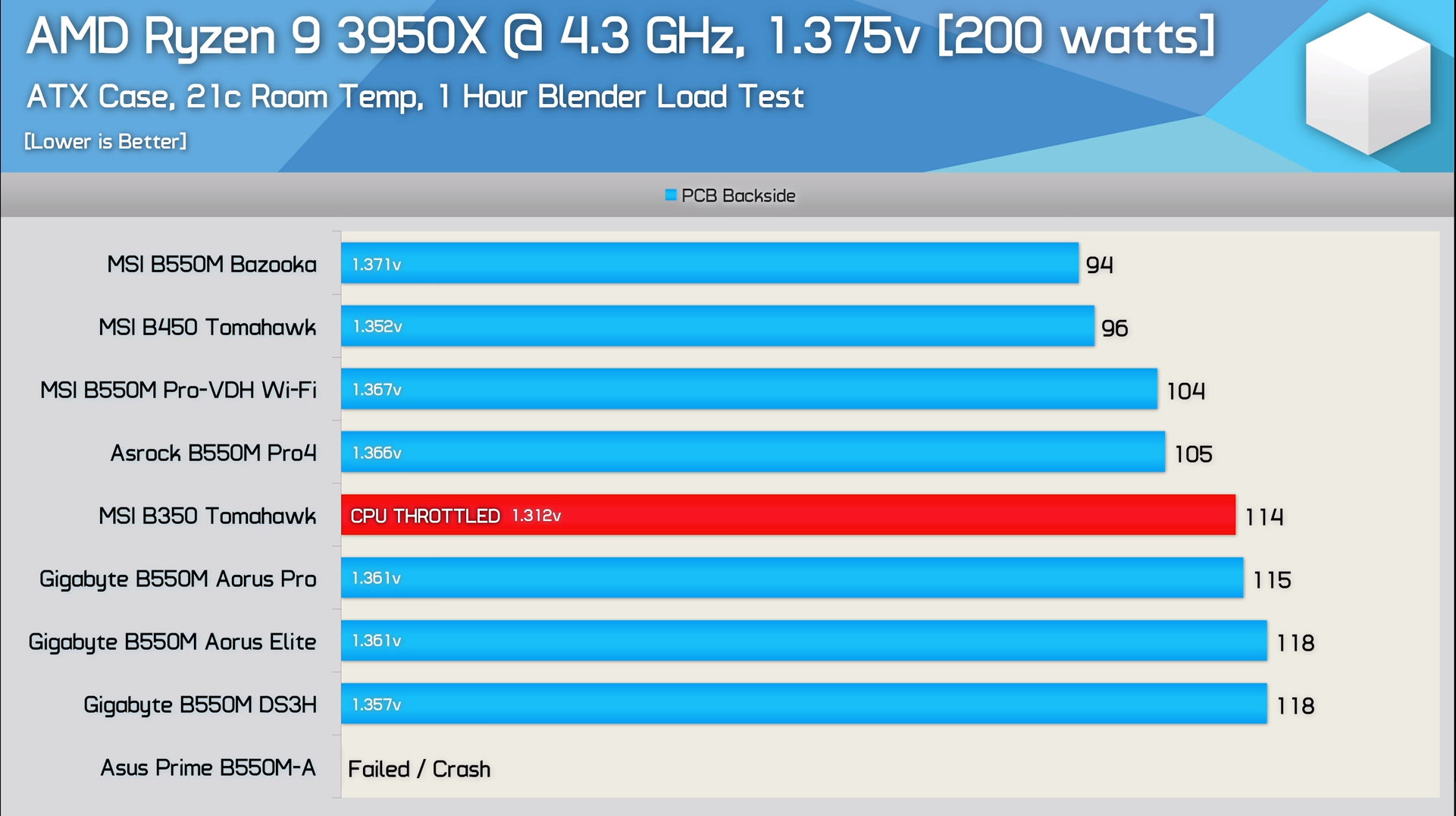

It is good conclusion that many form factor PCs will run hotter, like gaming laptops (but not to that extent). Remember that most reviewers usually keep room temp at 21C, so say an ambient temp of 30-35C will put real-life temps as +10-15C over those numbers. Also, many reviewers are running top of the end coolers like a 360mm AIO or so, those are expensive.
I'll say that don't expect 10-15% jump with OC as most manufacturers have been good at extracting as much performance as you can. Ryzen CPUs don't OC well enough like Intel ones do, but Intel ones get a lot hotter & draw a lot of power as well. Usually its not worth the effort.
Yes, B550 is worth the extra investment, esp if you plan to OC or upgrade to higher end CPU later, like maybe R7 4700X. When the temperature of VRMs of a mobo gets too high on load, it can throttle CPU performance or crash the system, as evident with Asus Prime B550 test on R9 3950X OC (2nd pic below). The B350 Tomahawk can be considered as a good indicator for cheap B450 mobos. As said earlier, India has higher ambient temps, so higher temps. But IMO, for R5 3600 or R7, even a cheap Gigabyte B550 DS3H is enough, costs just under 10k. Get MSI B550M Pro VDH WiFi (13.5k) if you want that inbuilt WiFi 5GHz module along with better VRMs.
Source: Hardware Unboxed

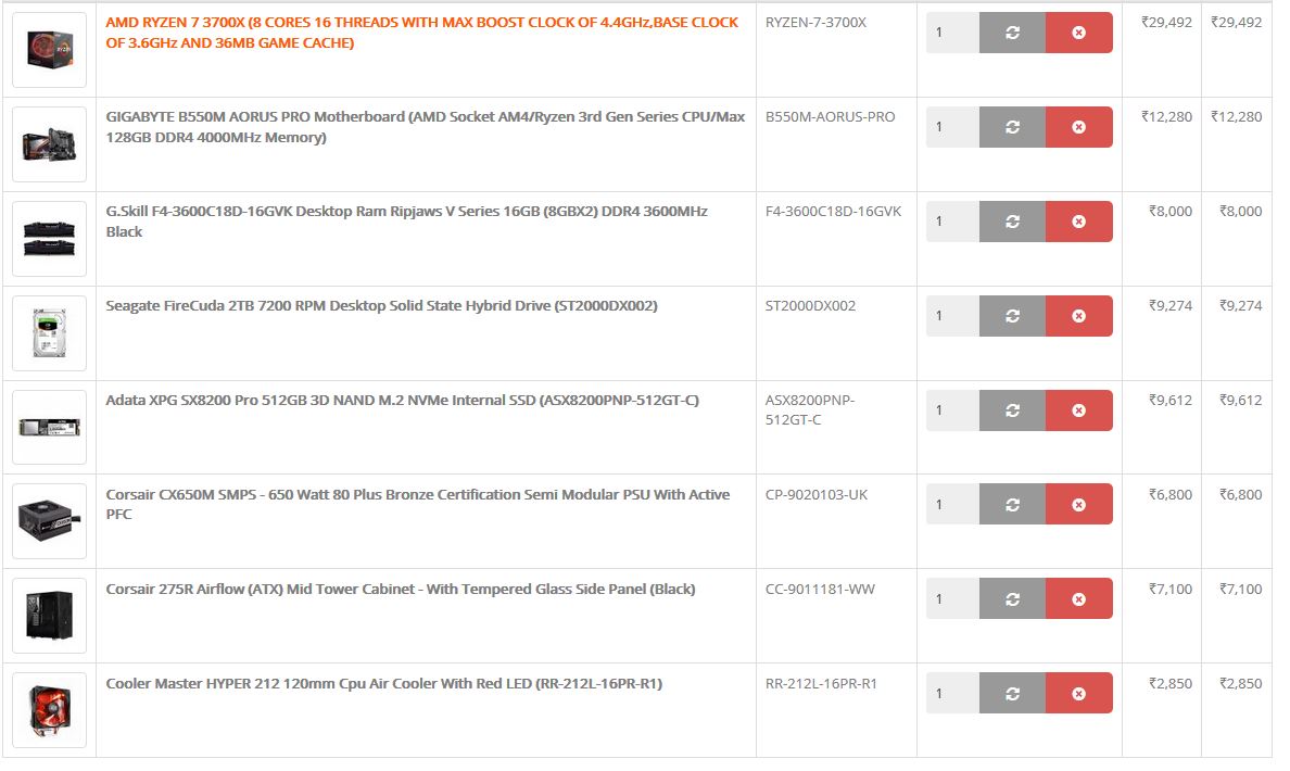

I got this config for 85.4k from M.D. Computers:
It excludes GPU and the prices are bit inflated. If @OP can get a little better price then he can add GPU for 40K (later) to stay in the budget.
How does it look?
monkey
Why spend 9.2k on a hybrid hdd/fake ssd? Should have got a regular 2TB hdd with 240gb ssd.
Actually I initially opted for regular 7200 rpm Seagate HDD for about 4.5k. But its just that Firecuda drives have 5 years warranty instead of 2-years on regular drives. Also I have read some reviews wherein they say that Firecuda 2TB has some performance benefit over regular 7200 rpm drives. Also Firecuda 2TB is available for around 8.2k at Nehru Place.
