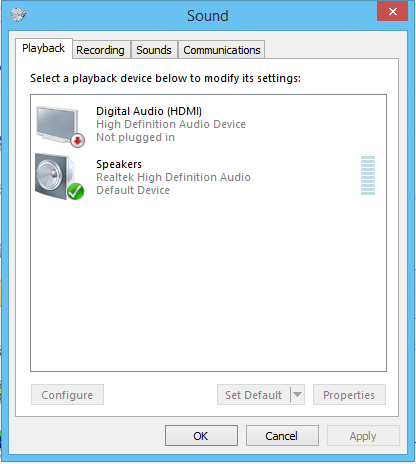

Here is the pic...front panel has earphone,back has speaker
Then use that only as that is the correct port.You need to check with a normal speaker(& not usb one) to confirm the issue.
P.S. have you tried connecting earphones to that red audio port in back?

YES,earphones are still connected,actually i was not tried to test speakers first but as earphones were not working i had to use it

That means something is not installed correctly.Are you sure audio drivers were installed correctly?
i downloaded from here Support For B450 TOMAHAWK MAX | Motherboard - The world leader in motherboard design | MSI Global
Even installed manually from CD but :(
Check the front panel audio pin connection(refer to manual) on mobo is correct.Then check in mobo bios settings anything related to audio/realtek & see that nothing is disabled(if it is then just post the name of value here for confirmation).
