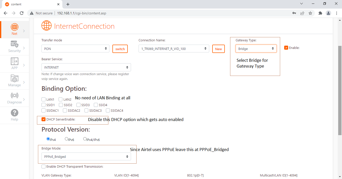

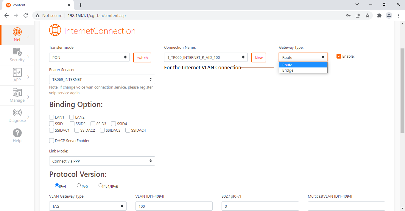

In NET -> WAN Setup you will have 2 connections under Connection_Name, one for Internet & another for Voice. Select your Internet VLAN connection from the drop down. Now the next drop down is Gateway Type – Options are Route (Default) or Bridge.
Select Bridge. Now the Bearer_Service auto changes from TR069_Internet to just Internet. That’s normal.
DHCP Server gets enabled automatically. Just uncheck that. Also In dropdown named Bridge Mode below, it will auto select PPPoE_Bridge as default. Leave that as it is because Airtel uses PPPoE.
While BSNL’s DBC router additionally required LAN Port binding, this device did not.
So, apply the changes and reboot the router. That’s it!
Optionally Disable DHCP Server in Net -> LAN options and disable WiFi as they have no role to play. However, if you are not an advanced user, leave DHCP running as it will be easy to connect back to this device later if you wish to, say to revert it back to Routing mode.
Plug a LAN cable from any of the LAN ports of 2122A to WAN port of your ethernet router. Now setup your own ethernet router full-fledged including PPPoE Internet connection, DHCP, WiFi and all advanced WAN dependent features that you may be interested in. Now it’s your own Ethernet router front ending ISP’s Internet WAN. Voice remains unaffected and will continue to be handled by the fiber router.
