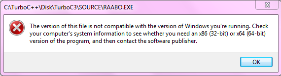

So,why is this error coming?
I created the .exe file with Turbo C++ of whose screenshot I posted earlier.

> My hypothesis: TurbiC is a 16 bit program so the EXEs generated by it are also 16 bit which cannot be run on a 32/64 bit machine.

We already told you that TC++ is just a peice of carp and not to use it. Anyway, Try running that compiled program in Win95 or Win98. It would work.

I changed the compatibility to Win95&98.
Still same error persists.
