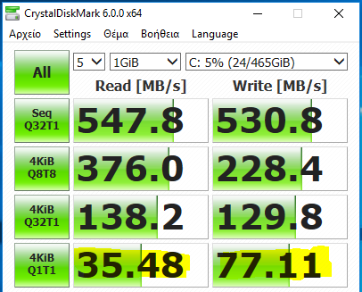

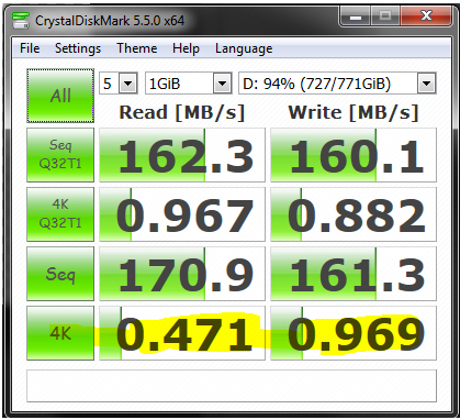

Then 1MB/s is normal,it is called random 4K read write speeds & these are the speeds that matters for OS operation & the reason why SSDs are much faster than HDDs for OS/running usual tasks.
Typical HDD:
Typical ssd:

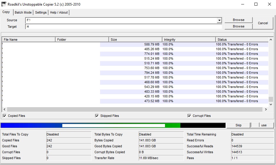

After that on those pesky files which could not be copied you can try Unstopable Copier, a utility from Roadkill.net (I have not personally used it with Windows 10 yet) by keeping settings such that it will skip only the error filled sector after 1 try. After you have extracted whatever you can with this setting, you can try multiple effort settings so that it will try the maximum to recover any bad sector.
Roadkil.Net - Roadkil's Unstoppable Copier Program Download
Tried FFS, it did help in copying few folders. Thanks but there is a little difference in the number of files etc.
Can it be ignored? It has zillions of files, no time to manually check every file. Now there are other folders mainly 20+gigs which will stop the process or cause FFS or Unstoppable copier to hang. Copying one file at a time is not possible

This picture shows success. Why do you say it got stuck?
TeraCopy is good. I use it regularly as a replacement of Windows' copy function.
Check the completion bar below, the green one stuck from the past 4 hours so I cancelled it and there were like 400 more files it did not skip this one and moved to the next. All settings are default.
