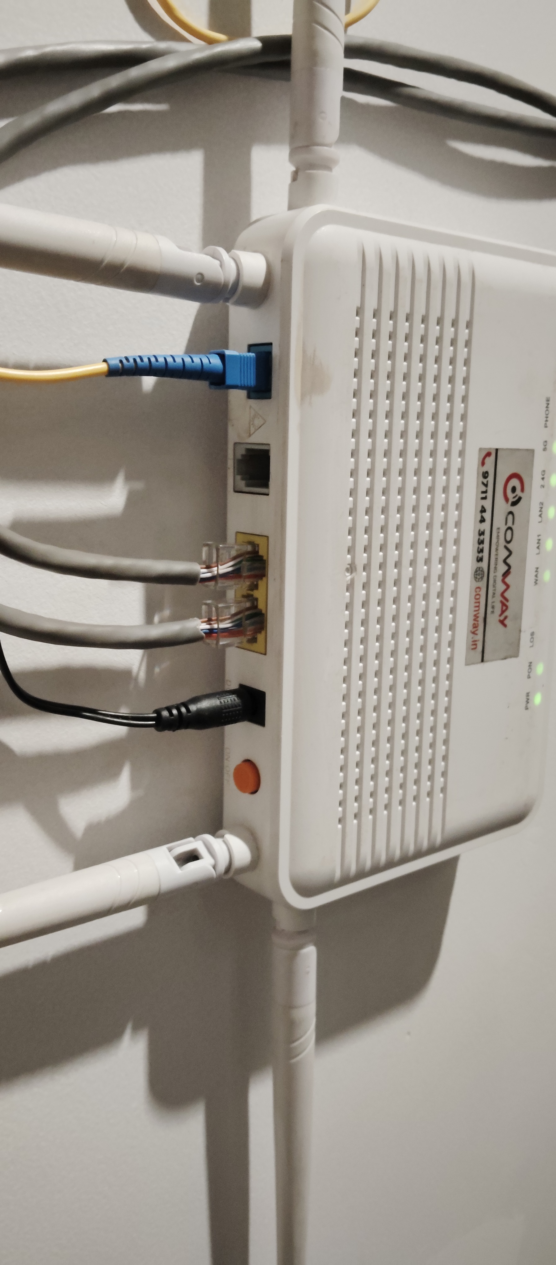

I tried creating mesh network but it was not able to give food coverage to all parts of those floors.
Hence I HV put cat6 wire on all floors for connecting the m4 and the n301 router with the router provided by comway.
But now I found that comway router has only 2 lan ports, from one of that port I send one wire to 4th floor and from another port I send one wire to 2nd floor. From 2nd floor i connected one mesh and from that mesh i attached another wire which went till 1st floor. These settings were done by a network engineer.
1. Now the network is good on all floors except @st floor where I have used n301 router as it's speed is limited to 100mbps
2. As the main router has only two ports, i am unable to connect my cctv internet port to it.
Pls tell what to do for (1) increasing the speed and (2) connecting cctv port as I bought one splitter too but it didn't helped.

You've done so many things, why stuck with Comway router then, invest in a good router with more ports?
I know but their router is good and I don't want to invest much hence was thinking to buy either POE switch or network switch, whichever is better.
Pls also tell what is PoE injector ?
Vyom
The Power of x480
Switches are the best to convert 1 LAN port to more.
Just don't make the mistake of buying a non gigabit switch like I did (as mentioned in this thread: *geek.digit.in/community/threads/suggestion-on-a-switch-for-home-networking.212632/)
Also you might save a lot of money, if you don't need a PoE. Just get a gigabit switch.
