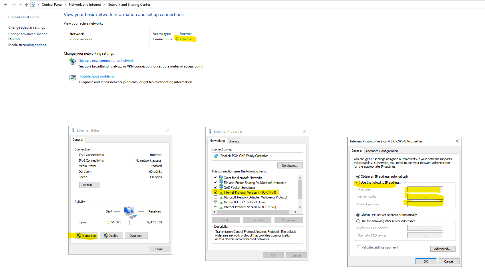

In your laptop wifi tcp/ip settings, manually set ipv4 to 192.168.18.10, subnet 255.255.255.0, gateway 192.168.18.56. Now see if it connects & shows as "limited connectivity error". If it does then try opening 192.168.18.56 in a browser.
P.S. Always post details of your connection setup especially any modem/router if present. I have never seen such default gateway value & ip range in a typical home wifi setup.

ipconfig /all taken from the laptop C:\WINDOWS\system32>ipconfig /allWindows IP Configuration Host Name . - Pastebin.com Same thing from a pc on the same wifi C:\WINDOWS\system32>ipconfig /allWindows IP Configuration Host Name . - Pastebin.com
Using my phone's hotspot as a wifi connection. Jio sim.
Filled those numbers manually, left the dns server empty as didn't know what to fill there and from unidentified network it has started showing the wifi's name
Unidentified network as seen earlier
Wifi name now
What to do now?
Edit- Connected to a new hotspot, another phone with a jio sim, using the same values in ipv4 etc. as filled above and it shows unidentified network
Changed it to auto select the ipv4, subnet etc. and it says identifying
