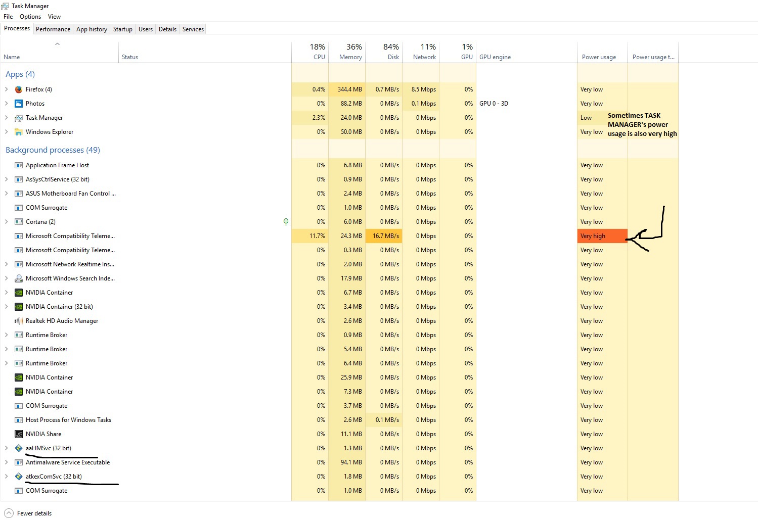

In 2nd last screenshot of task manager above there is a service "microsoft windows system pr..." with high disk usage(8.6MB/s) which my guess is system protection service related to system restore points.Try disabling this service to see if it helps.
How to disable it? From registry?

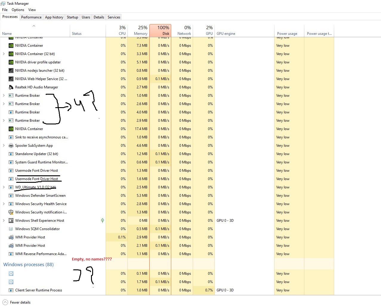

An update. WD is still deactivated but now the disk usage is like 100% even after 5-10 minutes, check the screenshots-
*i65.tinypic.com/5f52u1.jpg
What are these green icons?
*i66.tinypic.com/15hy7nt.jpg
After about 15 minutes the disk usage went to normal
*i66.tinypic.com/34i0ffs.jpg
@whitestar_999
I did not find any microsoft windows system pr.... or system protection anywhere. What's wrong here?

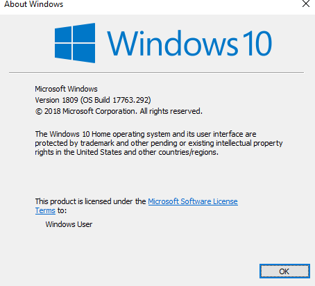

Try solution 1 & 2,looks like a windows update related issue.
Fix: High Disk or CPU Usage "Service Host Delivery Optimization" - Appuals.com

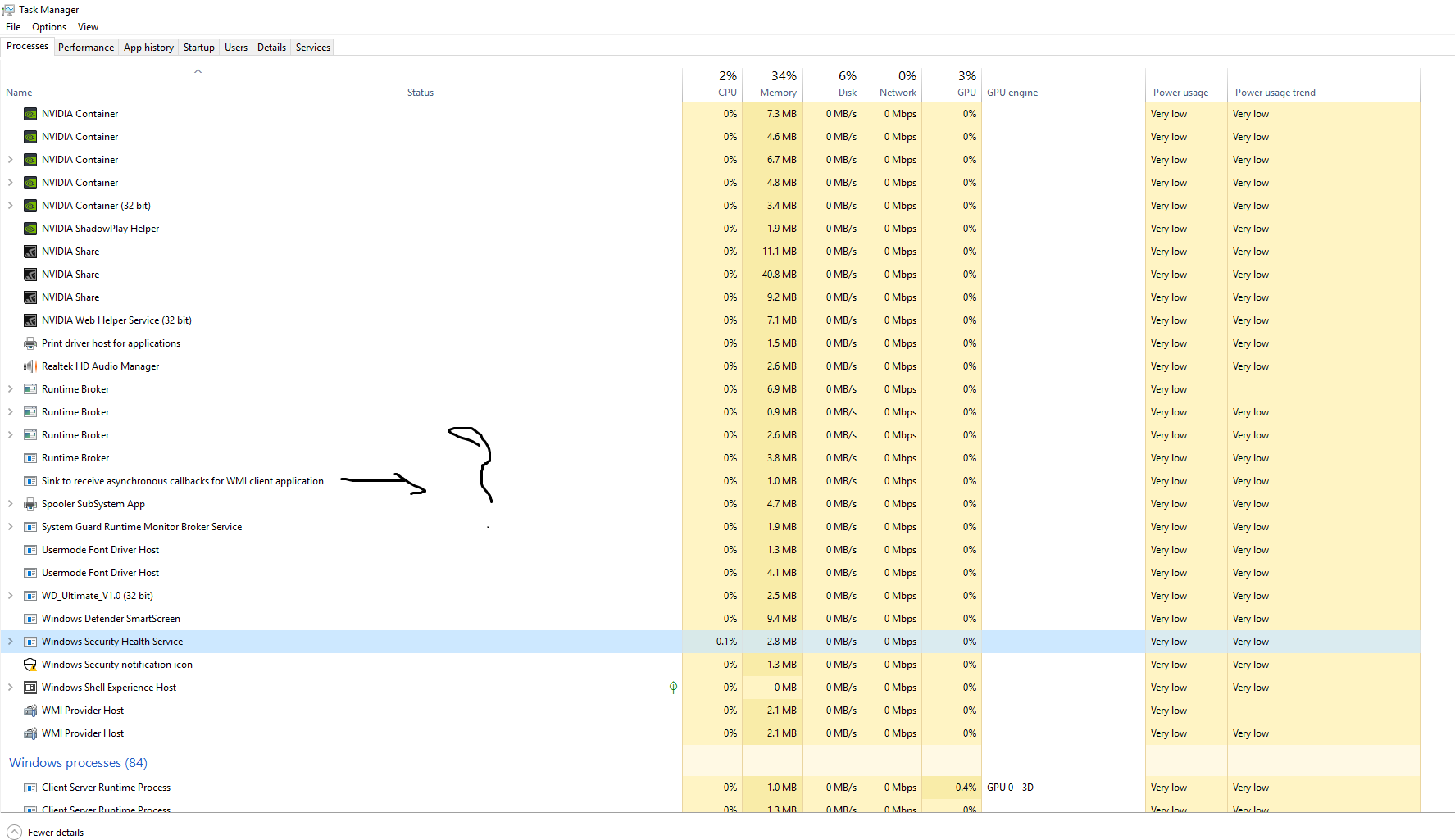

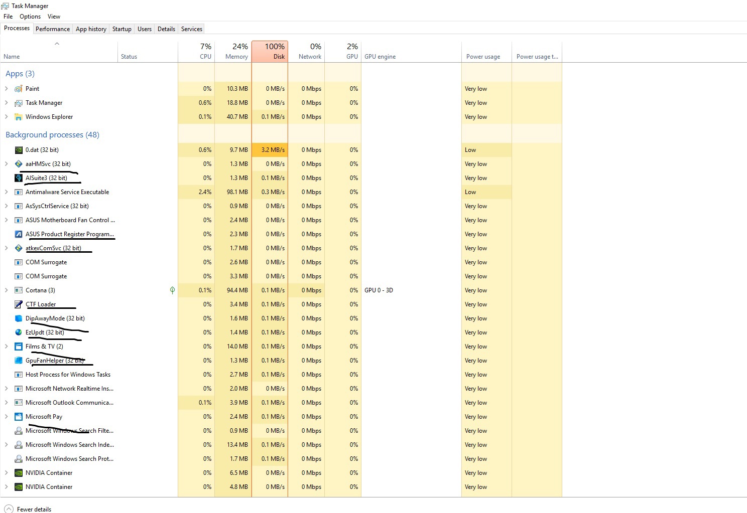

I didn't get time to follow the steps as mentioned in those threads. Switched on the system today, its updated to the latest version. Still slow when switched on and now the time of slowness has increased about t+5 minutes.
Check the screenshots, what are those highlighted things doing there? + @Minion

1st pic top 4 are asus related services,you can leave them as it is.Other 6 below are apps,you can turn off their updates using app settings in control panel.
2nd pic those 4+3 underline are all ms system services.
3rd pic the reason for very high disk usage is ms telemetry service & there is nothing much you can do about this.This is also one of the main reason to get a ssd for running win 10.The other 2 underline are asus related services most likely those function keys/touchpad related.
4th pic again ms system service.
Most interesting among all these 4 pics is 0.dat service(1st service in 1st pic) by nvidia.
*forums.geforce.com/default/topic/1054122/geforce-experience/what-is-0-dat-/2/
0.dat is a heavy compressed download of the ApplicationOntology folder which is where all the game setting stuff of GeForce Experience is. When it detects an outdated version it will download it and update the game settings profiles this way. 0.dat running is it beeing extracted.
The disk usage comes from the fact that it is a 3.6mb file that extracts into a 90mb folder with 2700 files which takes 10s even on my ssd and probably a lot longer on a harddisk because of the big amount of small files which hard disks really hate.
Of course the main issue is still that ms telemetry service but this 0.dat service should also be kept under check.

@whitestar_999
Not able to find those 6 in control panel. Where are they located?
Done.
Well my laptop is also having a normal hdd. Why isn't the telemetry service slowing it down? Leaving the asus one's as it is.
Done
Can I disable block this 0.dat service? Did you check those no name services?

Yes,that 0.dat service can be safely disabled,worst case scenario you will need to download & update nvidia driver/components manually by downloading them from nvidia site.

0.dat is nvidia geforce experience remove geforce experience from control panel its useless
