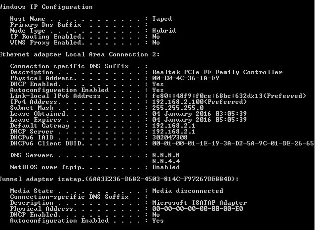

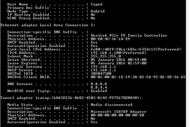

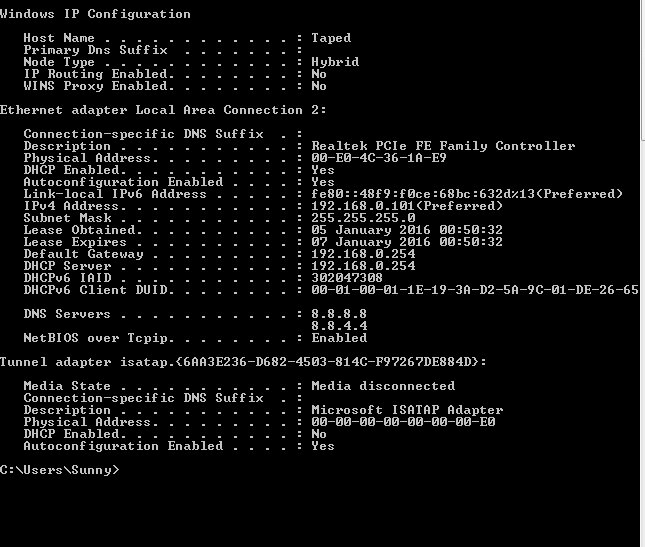

missing the most important thing,result of ipconfig /all command in command prompt for various situations stated above.

that's why my earlier suggestion.run that command,save the result(& post it here) & if this problem comes up again then post ipconfig result for that time.

here they are
it started showing problems again today. First one is when it is directly connected.
Second one is when it is connected through router but not working

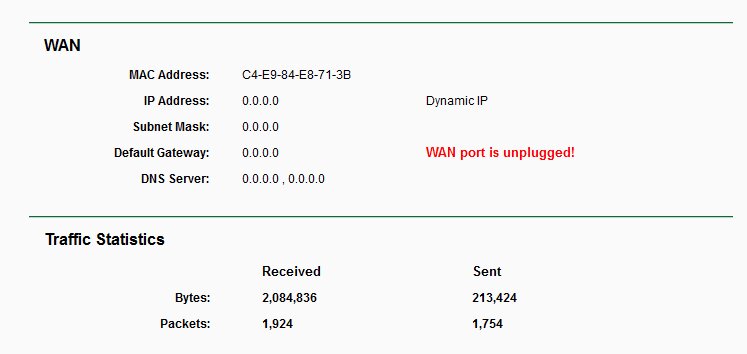

i get the following screenshot every 10 secs even though the cable is properly plugged in-

also what do you mean by getting screenshot every 10 seconds even though the cable is properly plugged in.

and this is the error that comes continuously. Facing this problem since morning
*s21.postimg.org/oir51msyv/screenshot_of_tplink_manager.jpg
Disable DHCP in tplink,save,restart tp-link & cpe,& then see.also just for the sake of it try with a different/new lan cable to connect tplink to cpe.
