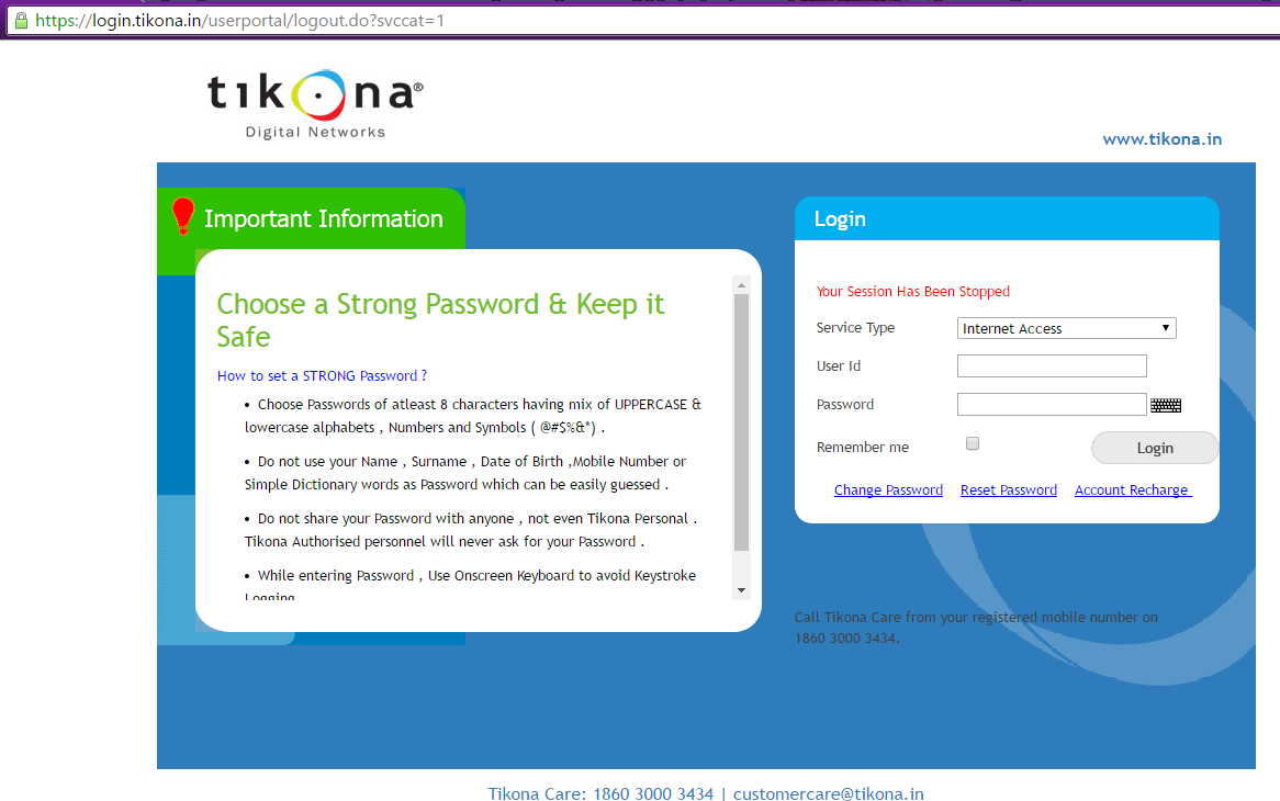

hi, my login looks something like this.
but basically you should be able to modify script to login to 24online url.
for example, we need to send the cookie information & the login details to the login URL.
you can use Fiddler to see what information is being sent while doing a login.
To login to Tikona, i have to do 1.254.254.254. which redirects to *login.tikona.in.
with the cookie got from 1.254.254.254
your login data should be different/simple. All hardwork is done by Curl to get and send data to these URLs. we just have to know what has to be sent and where to do the login.
