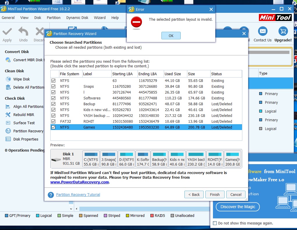

I tried again and now this error. I can't understand which partition it is talking about?

I tried by deleting/skipping one partition to recovery but when I clicked 'apply' the PC crashed back to DISK BOOT FAILURE. I again tried to recover the PC using my system disk but this time it is unable to recover the PC startup.
Please help.....
