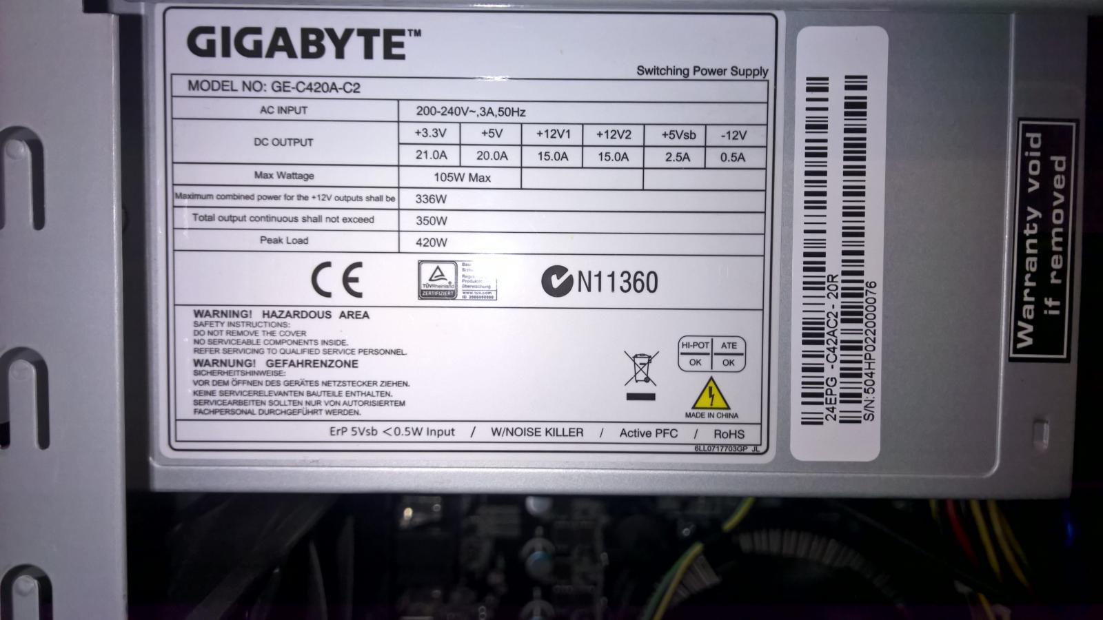

Thirdly for my Current setup the PSU is the Generic 460W Gigabyte branded which was with the case, is that fine for now or should I change it ASAP ? The GPU is a Gigabyte Twin force So it needs a pin.
PSU pic:

For basic Intel configuration; there is no need for High wattage PSU. For ease of mind and future proof rig, I would suggest you to go with the high wattage PSU like 500W. With that in future, you can upgrade the other peripheral components like SSD, HDD and GPU.

Always connect your monitor to your GPU . What do you mean my Optimus Thing? Optimus is a mobile GPU feature. I have a GTX 750ti and i dont have any Optimus feature.
Your GPU is not very demanding. No need to upgrade your PSU. Upgrade your PSU when u plan to buy a faster graphic card in the future.

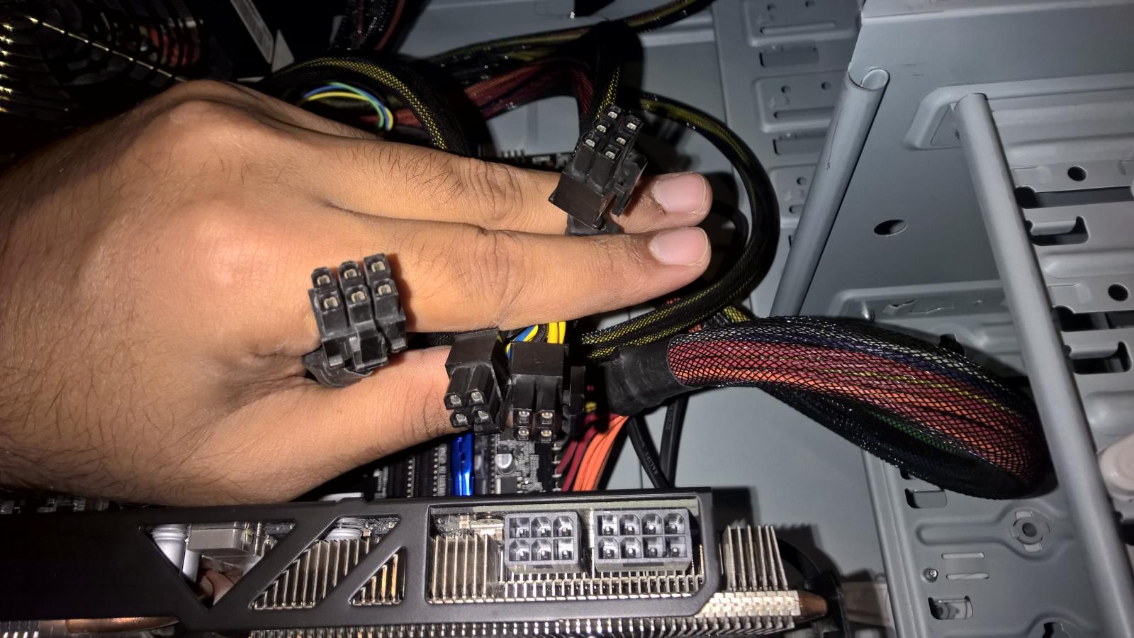

Thanks Guys the Resolution part if fine.. I have a new issue actually the powers supply I used was Old running absolutely fine. But I got a Gigabyte Windforce 770 4GB GPU. Now the PSU Only have 2x6pin and 2x4pin and the GPU require 1x6pin and 1x8pin.
My question is can I connect two 6pin and leave the last two pins.. I m not intending to Overclock. Do have a look on my PSU ratings I have uploaded below.

Based on my knowledge, each pin of circuit is important. We never know pin is Grounded or Vcc, if any pin is skipped in circuit; then there are maximum chances of short circuit in the device.
As a techie, I'd suggest you to use a 6 to 8 pin adapter cable to port.

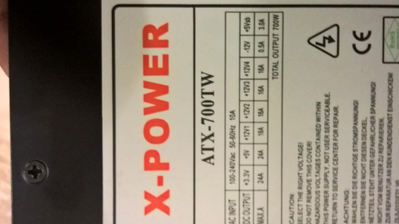

I m including the pic of the PSU ratings here. The thing that worries me the PSU is a Old one it is certified for Pentium 3.4 ghz SLI/Crossfire. Just need to know the amp and rail stuff is all ok the rig I mentioned above... and thanks will get the converter.. also can you sugggest a psu that is cheap but having 2x 6+2 pci-e pins
Actually i saw people saying you need two 6 pin to 8 pin connector... my psu only have 1 6pin left is that fine ?

You can go with Antec VP550P -3575.

Actually I have one Corsair VS 550w.. is this good ?
Hi [MENTION=127200]zacfx05[/MENTION],
In my opinion, for basic PC configuration; there is no need for High wattage PSU. For ease of mind and future proof rig, I would suggest you to go with the normal wattage PSU like 550W. With that in future, you can upgrade the other peripheral components like SSD, HDD and GPU.
If you have the spare PSU then go ahead to upgrade your build.
